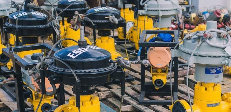

ESD valves are used to isolate the facilities in emergency situations. An ESD (emergency shutdown) valve is a valve fitted with a spring return actuator, allowing the valve to be closed by the actuator spring when the actuator pressure signal is released.
Shutdown valves (SDV) are widely used to reduce the escalation of hazardous from one system to another in the oil and gas production process for safe and proper isolation purposes. General shutdown valve is controlled by a high integrity Emergency Shutdown System (ESDS).
ESD valves are usually quarter turned ball valves, but they can also be sliding stem gate valves or other types, although less common.

How does ESDV Works?
Full Open Position โ€“ Normal Operation
When the valve is in full open position, the ESDV offers limited pressure differential. The full bore ball valve is essentially a tube that reduces the liquid friction of the system.
