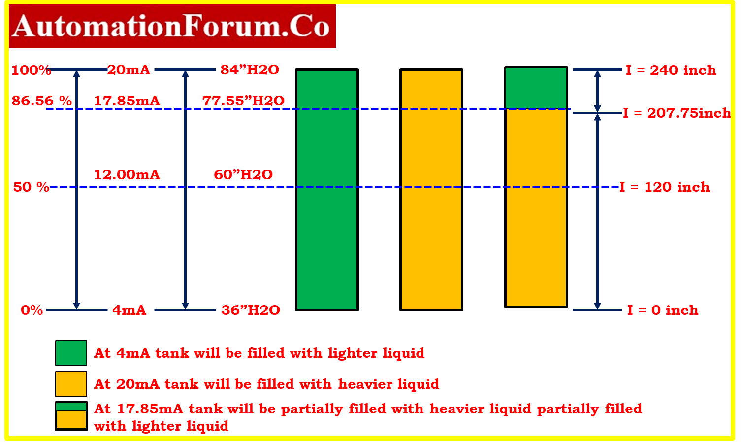

- Graphic representation of measurements taken at the interface level can be seen below:

How do you measure interface level?
Example:
A vessel needs an interface measurement with a 240 inch level.
Two liquids with specific gravities of 1.1(SG2) and 1.3(SG1) are present in the container.
In order to calculate the calibrated range of the transmitter, four assumptions need to be made, and they are as follows:
1. The tank is filled with lighter fluid until it reaches the lower calibrated value, the 4 mA point.
2. The tank is filled with the heavier fluid until it reaches the upper calibrated value, 20 mA point.
3. The taps that go to the transmitter are constantly flooded. The total level must be at or above the upper (low pressure) tap.
4. The low pressure side may always observe a reference level. A wet leg or a remote seal system can be used to achieve this. The height and density of the reference level must remain constant. When the density of the high and low pressure wet legs is different, the calculation for wet leg systems is somewhat altered.

Calculation of interface measurement
When the tank is filled up to its full capacity with lighter fluid,
The transmitter will be set to 4 mA (or 0% of its span), and L2 = L:
HP = L2S2 + dSf
LP = dSf + hSf
At 4 mA,
DP = HP – LP
= (L2S2 + dSf)-(dSf + hSf)
= L2S2 – hSf
DP = (240 X 1.1) – (240 X 0.95)
=264 – 228
4 mA = 36 inH2O
The transmitter will be at 20 mA (or 100% of span) when the tank is full of the heavier fluid, and L1 will equal L because of this.
HP = L1S1 + dSf
LP = dSf + hSf
At 20 mA,
DP = HP – LP
= (L1S1 + dSf)-(dSf + hSf)
= L1S1 – hSf
DP = (240 x 1.3) – (240 x 0.95)
= 312 -228
20 mA = 84 inH2O
The calibration range is between 36 and 84 inH20.
When the transmitter reaches a reading of 36 inH20, the tank is considered to be completely full with lighter fluid.
When the transmitter reaches a reading of 84 inH20, the tank is considered to be full of the heavier fluid.
To establish the location of a fluid mixture’s interface, utilize the DP measurement as a percentage of span.
How do you calculate interface level?
When the transmitter output is 18.4 mA or the DP is 20.7 inH2O, for instance, the interface level is determined using the following formula:
where, LCV= lower calibrated value
DP = Differential pressure indicated by the transmitter
Span = LRV – URV
L = Span Engineering range of the tank
Interface level I = {(77.55 – 36.00)/48} X 240
= (41.55 /48) X 240
Interface level I = 207.75 inches
| Transmitter output – mA | DP value – inH2O | Interface level – inches | Level – % |
| 4.00 | 36.00 | 0 | 0 |
| 8.00 | 48.00 | 60 | 25 |
| 12.00 | 60.00 | 120 | 50 |
| 16.00 | 72.00 | 180 | 75 |
| 17.85 | 77.55 | 207.75 | 86.56 |
| 20.00 | 84.00 | 240 | 100 |
