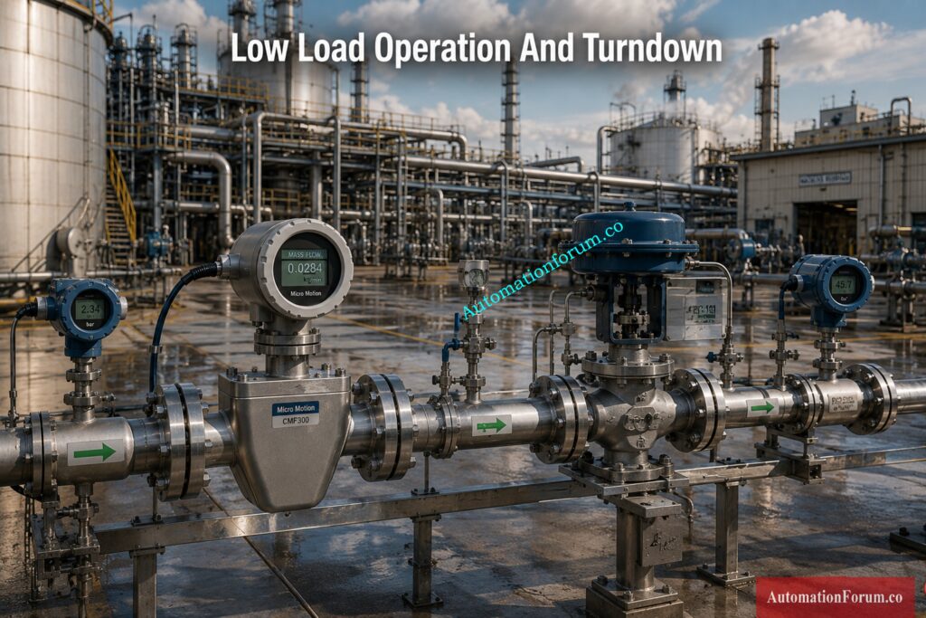

Effect On Low Flow Measurement
Turndown ratio directly affects how useful an instrument will be across real operating conditions. Many plants do not run at one fixed load. They start up, shut down, ramp up, reduce output, switch products, or handle seasonal demand. A good turndown ratio helps the instrument remain accurate during those changes.

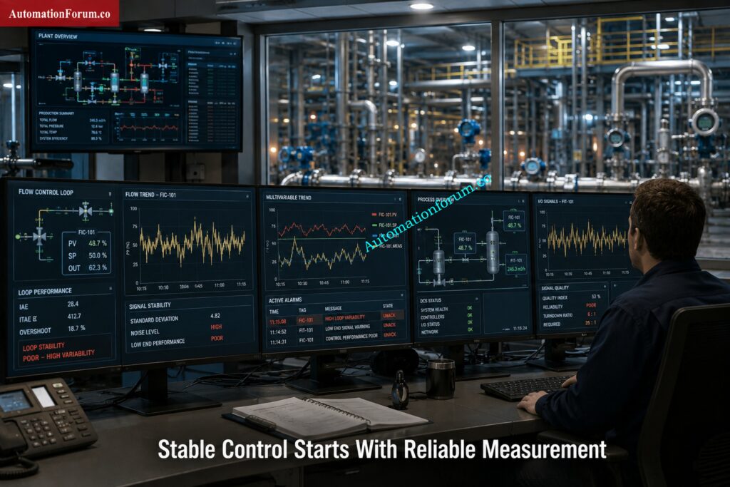

Effect On Control Loop Stability
It improves low flow measurement, especially where the process often sits far below maximum capacity. It supports better control stability because the control system receives a cleaner measurement signal. It also improves energy efficiency, because the plant can run closer to the real process demand instead of forcing equipment into an oversized operating window.
Effect On DCS,PLC And SCADA Performance
In DCS, PLC, SCADA, and PID loops, an instrument with poor turndown can cause noisy input values, poor controller response, and hunting. In safety systems, weak low end measurement may lead to incorrect status interpretation. In critical operations, that is not acceptable.

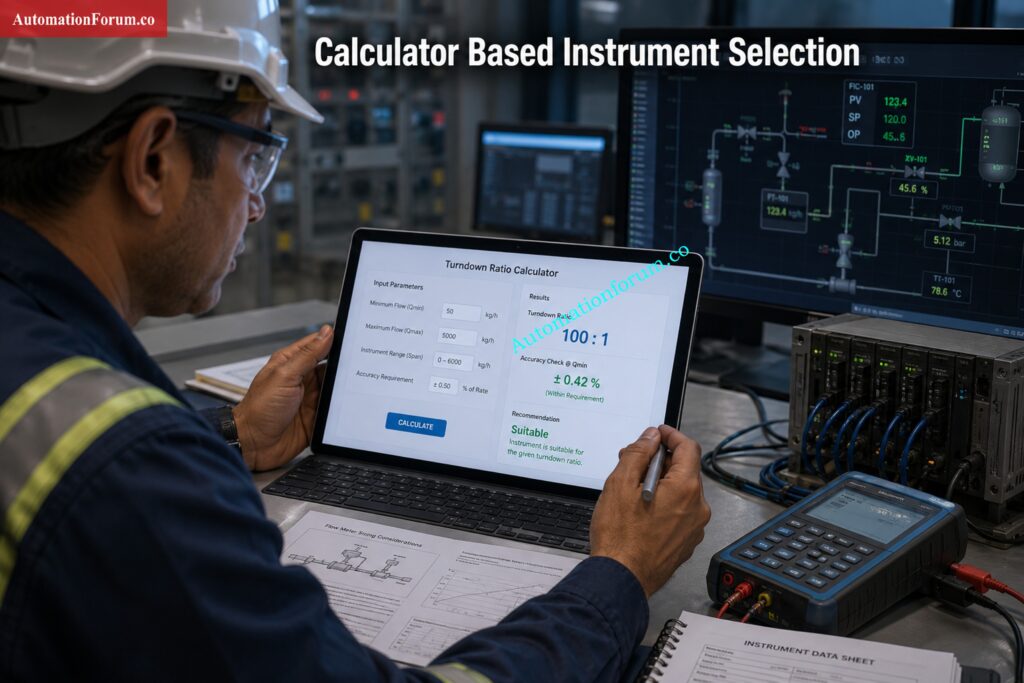

How the Turndown Ratio Calculator Works
The calculator in the attached file is designed as a practical engineering aid. It considers the process duty, instrument range, instrument turndown, and accuracy requirement, then gives a suitability judgment.

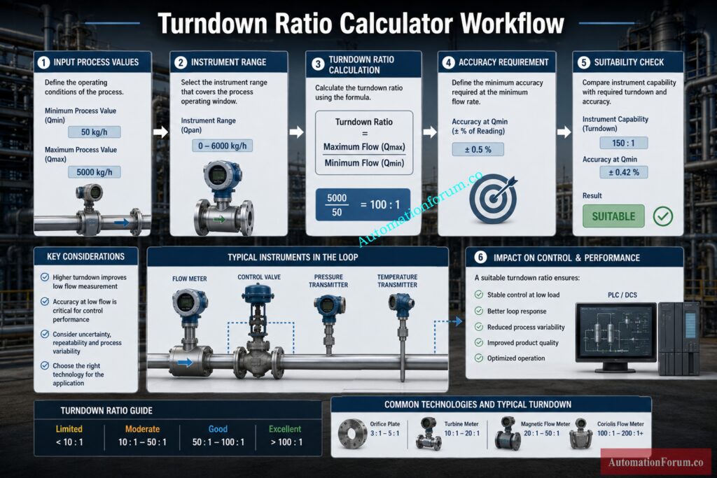

Turndown Ratio Calculation Formula
Process Span Formula
The calculator uses a few practical checks.
Minimum Measurable Value Formula
Process Span = Maximum Process Value minus Minimum Process Value
Calculated Turndown Ratio = Maximum Process Value divided by Minimum Process Value
Minimum Measurable Value = Instrument Range divided by Instrument Turndown

Example Calculation Using the Turndown Ratio Calculator
Step by step calculation
Consider a refinery application using a Coriolis flow meter.
Minimum flow = 10 m3 per hour
Maximum flow = 100 m3 per hour
Instrument range = 120 m3 per hour
Turndown ratio = 20 to 1
First, the process span is 90 m3 per hour.
The calculated turndown ratio is 100 divided by 10, which equals 10 to 1. That is within the selected instrument capability of 20 to 1, so the meter is technically suitable from a rangeability point of view.
The minimum measurable value based on the instrument turndown is 120 divided by 20, which equals 6 m3 per hour. Since the process minimum is 10 m3 per hour, the instrument can still measure below the lowest expected flow. That gives margin.
Operating utilization is 100 divided by 120 times 100, which equals 83.33 percent. That means the meter is being used effectively.
Suitability analysis of the selected instrument
If accuracy is 2 percent, low end accuracy by the calculator logic becomes 2 multiplied by 120 divided by 10, which indicates that the low end must be evaluated carefully. In a real refinery, this is where engineering judgment matters. The meter may be acceptable, but the low flow operating period should still be reviewed against the required control and custody needs.
The engineering recommendation is clear: the selected Coriolis meter is suitable, but the designer should still confirm start up flow, shutdown flow, and any possible low load conditions before final approval.

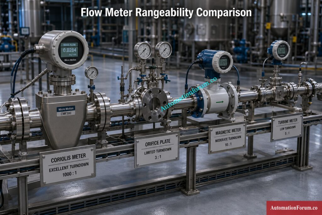

Typical Turndown Ratios of Different Instruments
Orifice Plate Turndown Ratio
Orifice plates usually have the most limited practical turndown because they rely on differential pressure, and the signal weakens quickly at low flow. They are economical and widely used, but low flow performance is not their strongest point.
Venturi Tube Flow Calculations Simplified for Industrial Engineers: Advanced Venturi Tube Flow Calculator – Formula, Working & Applications
Venturi Meter Turndown Ratio
Venturi meters generally perform better than orifice plates in terms of pressure loss and rangeability, which makes them useful where energy loss must be reduced.
Vortex Meter Turndown Ratio
Vortex meters can offer good performance in certain liquid, steam, and gas duties, but the minimum flow requirement must be checked carefully.
Turbine Meter Turndown Ratio
Turbine meters can provide good accuracy in clean fluids, yet they are more sensitive to viscosity, contamination, and low flow conditions.
Magnetic Flowmeter Turndown Ratio
Magnetic flow meters usually provide strong rangeability for conductive liquids and are often preferred in water and wastewater service.
Coriolis Flowmeter Turndown Ratio
Coriolis meters are widely valued for excellent mass flow measurement, high accuracy, and strong turndown in many applications.
Ultrasonic Flowmeter Turndown Ratio
Ultrasonic meters can offer wide rangeability, especially in large line sizes and gas or liquid services, although installation quality is important.
Rotameter Turndown Ratio
Rotameters are simple and useful for local indication, but their practical turndown is usually limited.
Pressure Transmitter Turndown Ratio
Pressure transmitters can have useful rangeability when properly selected, but calibration range and process noise must be considered.

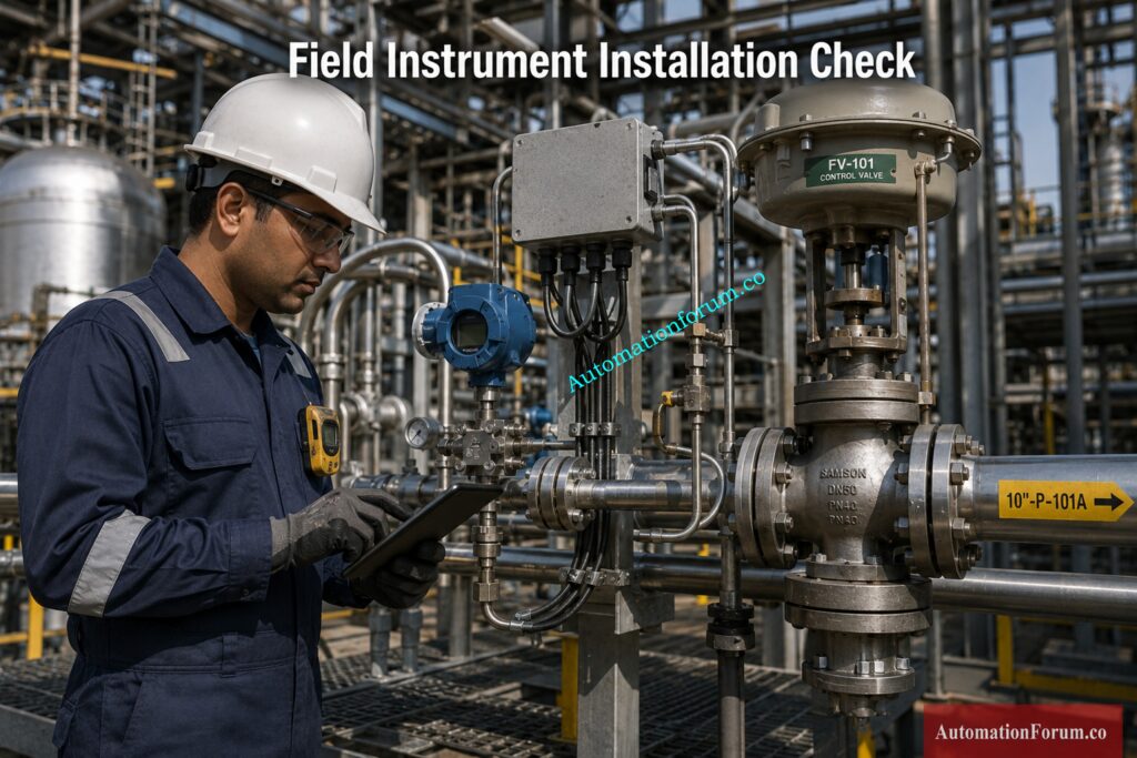

Common Mistakes in Instrument Turndown Selection
- One common mistake is oversizing the meter. Engineers sometimes choose a larger device for future growth, but the immediate effect can be weak low end resolution.
- Another mistake is ignoring low flow conditions. Many processes spend a large portion of their time at reduced load, so the minimum operating point must be checked carefully.
- Wrong transmitter calibration is also a frequent issue. A transmitter calibrated too broadly may lose useful resolution.
- Incorrect pressure drop assumptions can distort selection for DP devices and control valves.
- Ignoring process variability is another problem. Real duty is influenced by batch fluctuations, seasonal changes, and changes in operating mode.
- SIL mismatch can create a safety concern when the selected instrument does not fit the protection function.
- A good troubleshooting method is to compare the real process minimum with the practical minimum measurable value, then review accuracy and control stability before final selection.
