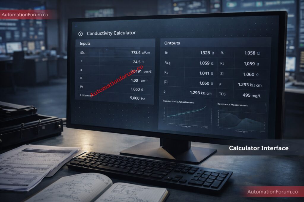

The conductivity probe calculator gives instrumentation engineers a lot of important information that helps them better understand how to measure conductivity and how probes work electrically.
Probe resistance (process temperature) - Conductivity Liquid Analyzer Probe Resistance Calculator
The liquid's resistance between the probe electrodes at the process temperature. This number shows how much electrical resistance the conductive solution between the sensor electrodes has.
The temperature-compensated resistance value is based on the standard temperature of 25°C, which is often used as a reference point for measuring conductivity.
It includes the resistance of the probe and the cable. This number helps engineers figure out the total resistance that the analyzer input sees and whether signal loading problems might happen.
 How a Dissolved Oxygen Analyzer Works in Industrial Water Systems: Dissolved Oxygen Analyser Working Principle
Calculated automatically with temperature compensation. The calculator updates the conductivity value based on the temperature coefficient because conductivity changes with temperature.
Takes into account both resistance and capacitive reactance. In systems that assess conductivity using AC excitation impulses, impedance is the total resistance to electrical current.
Resistivity is the opposite of conductivity. It is often used to measure ultrapure water, when very low conductivity levels are checked.
TDS is a rough estimate based on conductivity that shows how much dissolved material is in water.
Typical conversion:
TDS ≈ Conductivity × 0.64
The calculator gives these values right away, which lets engineers check the behavior of the probe, make sure the analyzer is set up correctly, and learn more about the electrical properties of conductivity measuring loops.
