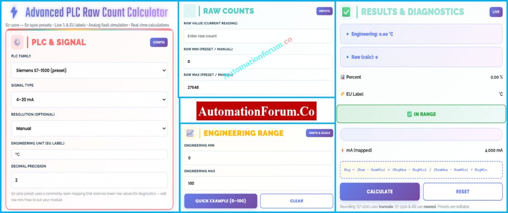

⚡ Advanced PLC Raw Count Calculator
PLC & Signal
Raw Counts
Engineering Range
Results & Diagnostics

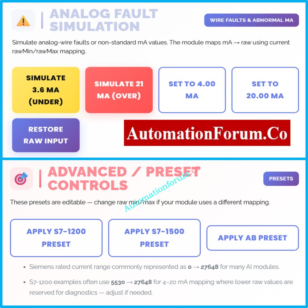

Analog Fault Simulation
Simulate analog-wire faults or non-standard mA values. The module maps mA → raw using current rawMin/rawMax mapping.
Advanced / Preset Controls
These presets are editable — change raw min/max if your module uses a different mapping.
- Siemens rated current range commonly represented as 0 → 27648 for many AI modules.
- S7-1200 examples often use 5530 → 27648 for 4–20 mA mapping where lower raw values are reserved for diagnostics — adjust if needed.

What is a PLC Raw Count Calculator?
Using linear scaling math, a PLC Raw Count Calculator turns raw analog input values from a PLC into useful engineering units. It also lets you get from engineering values to raw counts in the opposite direction.
Analog input modules turn electrical signals like 4–20 mA or 0–10 V into digital form and then give you raw counts. These numbers are based on:
- PLC manufacturer
- Analog module resolution
- Signal type
- Diagnostic reserve ranges
The calculator uses the same scaling method that PLCs use internally, so the conversion is clear and can be checked.

Analog Fault Simulation Using a PLC Raw Count Calculator
Fault modeling is a big plus for a PLC Raw Count Calculator.
Common Simulated Conditions
- 3.6 mA → Under-range (broken wire, broken sensor)
- 21 mA → Out of range (short circuit, transmitter problem)
Why Fault Simulation Matters
Engineers can check the following via failure simulation:
- PLC diagnostic bits
- Alarm activation limits
- Interlocks for safety
- Messages from the operator on HMI
This may be done without hurting wires or tools, which makes it very handy during FAT and SAT.
