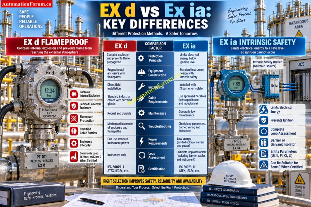

EX d vs EX ia: Key Differences
| Engineering consideration | Ex d | Ex ia |
| Protection principle | Contains an internal explosion | Limits energy to prevent ignition |
| Equipment construction | Certified flameproof enclosure | Energy limited electrical circuit |
| Energy limitation | Not the primary protection principle | Fundamental to protection |
| Typical instrumentation | Transmitters, switches, local equipment and higher power devices | Transmitters, sensors and measurement circuits |
| Zone suitability | Commonly Zone 1 and Zone 2 when certified | Can be suitable for Zone 0, Zone 1 and Zone 2 when certified |
| Installation | Requires careful enclosure and entry installation | Requires complete loop verification |
| Cable and gland considerations | Certified entries and suitable glands are important | Cable characteristics form part of the intrinsic safety assessment |
| Maintenance | Enclosure integrity must be preserved | Circuit parameters and segregation must be maintained |
| Troubleshooting | Focuses on enclosure, flame paths and entries | Focuses on circuit energy, barriers and parameters |
| Barrier requirement | Normally not required solely because of Ex d | Associated apparatus is normally required for an Ex ia circuit |
| Loop considerations | Mainly installation and certified assembly considerations | Complete circuit compatibility is fundamental |
| Certification | Equipment certificate and installation conditions must be checked | Equipment and associated apparatus compatibility must be checked |
| Installation complexity | Often higher mechanical installation requirements | Often higher electrical design and documentation requirements |
| Main advantage | Suitable for equipment requiring enclosure based protection | Excellent for low energy instrumentation circuits |
| Main limitation | Heavier equipment and greater enclosure installation requirements | Limited energy availability and more detailed loop verification |
The comparison should not be interpreted as one method being universally better. The correct protection concept depends on the application and certified equipment.

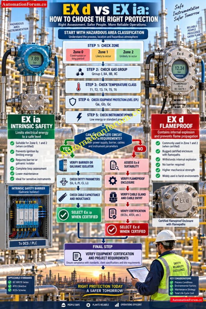

Ex d vs Ex ia: How to Choose the Right Protection
A practical selection sequence is:
Start with the hazardous area classification: Check the Zone, gas group, temperature class and required equipment protection level.
Check the instrument: Determine the instrument type, power requirement, signal type, voltage and current requirements.
Check the certification: Confirm that the actual equipment certificate and marking support the intended application.
Evaluate Ex ia: If the instrument is suitable for intrinsic safety, verify the associated apparatus and complete loop parameters.
Evaluate Ex d: If intrinsic safety is not suitable or the equipment is designed for flameproof protection, verify the enclosure certification and installation requirements.
Check the project philosophy: Confirm the selected method against the project specification, hazardous area philosophy, inspection requirements and maintenance strategy.
This approach is more reliable than simply asking whether Ex d or Ex ia is safer. The correct question is whether the selected protection concept remains valid for the complete installation.

Hazardous area classification is one of the first inputs for equipment selection.
Zone 0 describes an area where an explosive gas atmosphere is present continuously, for long periods or frequently. Zone 1 describes an area where such an atmosphere is likely to occur during normal operation. Zone 2 describes an area where it is not likely during normal operation and, if it occurs, exists only for a short period.
An Ex ia device can be suitable for Zone 0 when its certificate and marking provide the required suitability. Ex d equipment is commonly used in Zone 1 and Zone 2 applications when its certification permits the intended installation.
However, zone alone is never sufficient for selection.
The engineer should also check equipment protection level, gas group, temperature class, ambient temperature, certificate conditions and project requirements. A device certified for one application cannot automatically be assumed suitable for another hazardous area.
WIKA also notes that pressure instruments marked Ex ia can be suitable for Zone 0 under the applicable conditions, while Ex d pressure equipment can be suitable for Zone 1 and Zone 2 depending on its marking and certification.

Practical Example of Selecting Ex d or Ex ia
Consider a pressure transmitter installed near a hydrocarbon processing unit.
The first step is to establish the hazardous area classification. Assume the location is classified as Zone 1. The engineer then checks the applicable gas group, temperature class and required equipment protection level.
Next, the instrument specification is reviewed. The engineer determines whether the transmitter uses a low energy loop, the required supply voltage, signal type and power requirements.
If an Ex ia transmitter is selected, the associated apparatus must be checked. Suppose the barrier has an illustrative maximum output voltage of 24 V and maximum output current of 100 mA. These numbers are only an example and are not manufacturer approval values.
The engineer then checks whether the transmitter input parameters are compatible with the barrier output parameters. Cable capacitance and inductance are also included in the loop assessment.
If the required instrument power exceeds the available intrinsic safety limits, a suitable Ex d instrument may be considered instead, provided its certification matches the hazardous area and installation requirements.
The final selection is therefore based on the complete engineering arrangement rather than the protection label alone.

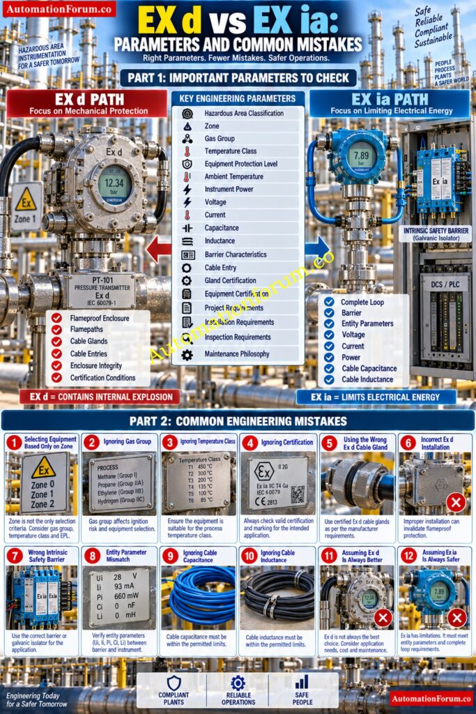

Important Parameters to Check Before Selecting Ex d or Ex ia
Before approving hazardous area instrumentation, check:
- Hazardous area classification
- Zone
- Gas group
- Temperature class
- Equipment protection level
- Ambient temperature
- Instrument power requirement
- Signal type
- Available voltage
- Maximum current
- Internal capacitance
- Internal inductance
- Cable capacitance
- Cable inductance
- Barrier or isolator characteristics
- Associated apparatus
- Enclosure requirements
- Cable entry requirements
- Gland certification
- Equipment certification marking
- IECEx or ATEX requirements where applicable
- Project specifications
- Installation requirements
- Inspection requirements
- Maintenance philosophy
For Ex d, pay particular attention to the certified enclosure, flame paths, cable entries and conditions of use.
For Ex ia, pay particular attention to the complete loop, associated apparatus, entity parameters and cable characteristics.
Identify Hazardous Zones Correctly Before Selecting Equipment: Hazardous area classification
Common Mistakes When Selecting Ex d and Ex ia Equipment
A common mistake is selecting equipment based only on the zone. The zone is important, but gas group, temperature class, EPL and certificate conditions also matter.
Another mistake is ignoring the cable gland. An incorrectly selected gland can compromise an Ex d installation even when the instrument itself has the correct certification.
For Ex ia systems, incorrect barrier selection is a frequent engineering problem. The barrier and field device must have compatible parameters.
Engineers can also overlook cable capacitance and inductance. These values can affect whether the complete intrinsic safety loop remains within its permitted limits.
Another mistake is assuming that Ex d is always more robust or that Ex ia is always safer. These assumptions ignore the actual protection philosophy and application.
Equipment should also never be operated outside the conditions stated in its certification.
