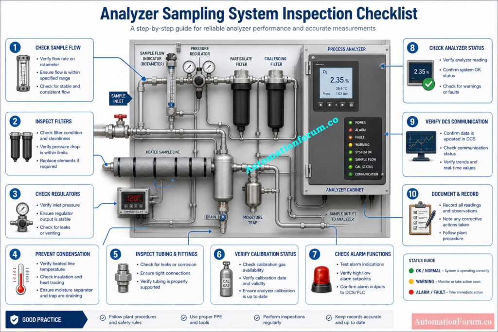

Importance of Analyzer Sampling System Inspection

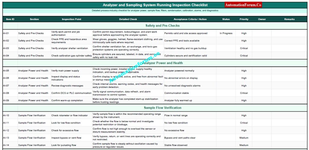

While the analyzer system is running under typical plant conditions, running inspection procedures are carried out.
The main goals of a routine running examination are:
- Prevent false analyzer readings
- Avoid unexpected analyzer downtime
- Detect sample system problems at an early stage
- Maintain stable sample flow
- Prevent moisture accumulation and condensation
- Improve analyzer response time
- Ensure stable process control
- Protect analyzer components from contamination
- Verify analyzer health and communication
- Ensure safe analyzer operation
Regular checks and preventative maintenance make analyzers much more reliable and plants much more efficient. Maintenance personnel can find problems before they impair process operations by constantly checking the conditions under which samples are handled.

Step 1 Verify Analyzer Power and Health Status
The first thing to do is examine the analyzer’s overall health.
Check the following things very carefully:
- Main power supply availability
- Analyzer display condition
- Status indications
- Diagnostic messages
- Alarm conditions
- Internal fault indications
- Communication with DCS or PLC
- Analyzer warm up condition
Make sure that the analyzer display is working properly and not showing any strange error messages.
Check to see if the analyzer and control system are able to talk to each other. If communication is lost, it could disrupt process monitoring and alert generating.
You should carefully look over diagnostic warnings because they often show early symptoms of problems with the analyzer, like detector faults, poor sample flow, low temperature, or calibration failure.
Dominate Gas Analyzer Interviews With These MCQs: Top 25 Essential MCQ for Gas Analyzer Instrument Technician Interview

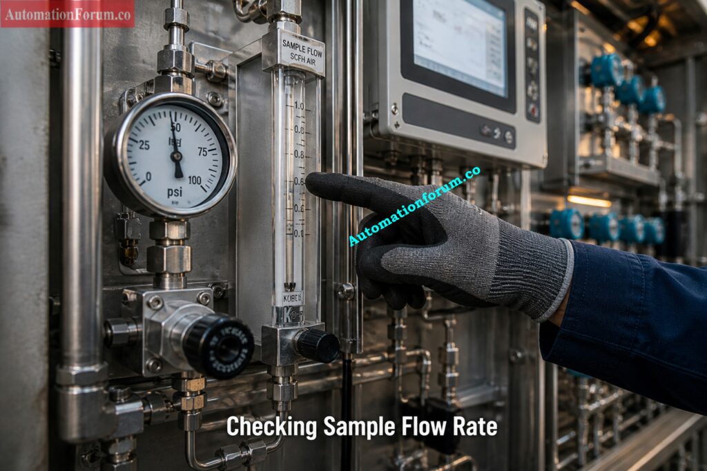

Step 2: Check Sample Flow Rate
One of the most critical components of checking an analyzer is checking the sample flow.
Check the rotameter or flow indicator to make sure that the sample flow is in the range that is recommended for operation.
During inspection:
- Verify proper sample flow indication
- Check for low flow condition
- Check for excessive flow
- Inspect bypass flow operation
- Look for pulsating flow
- Verify sample return or vent flow
- Check for blocked tubing or restrictions
If the sample flow is low, the analyzer may take longer to respond and give readings that are not steady.
Too much sample flow could overload the analyzer sensor and make the measurements less accurate.
Abnormal sample flow conditions are commonly caused by blocked tubing, unclean filters, frozen lines, or broken regulators.
In gas analyzer systems, flow instability is a common sign of difficulties with pressure regulation or filters that are only partially blocked.

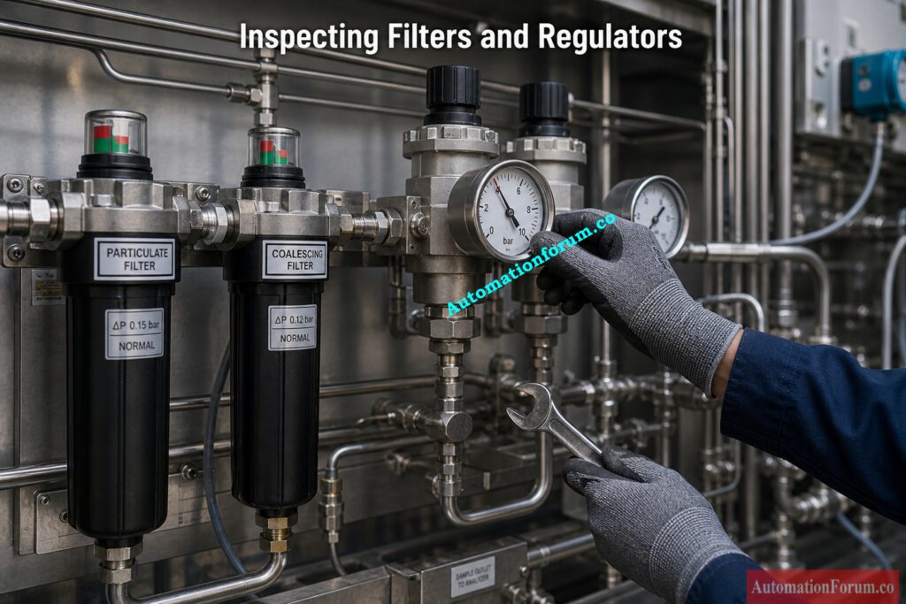

Step 3: Inspect Filters and Regulators
Filters and pressure regulators are two important parts of systems that condition samples.
Carefully look at the following parts:
- Particulate filters
- Coalescing filters
- Moisture separators
- Pressure regulators
- Differential pressure indicators
- Filter drain systems
Look for dirt, discolouration, moisture buildup, or a loss in pressure in the filters.
Dirty filters cause too much pressure loss and make the sample flow unsteady. This makes the analyzer respond slowly and gives wrong readings.
Check the stability of the regulator outlet pressure. When the pressure in the regulator changes, it can make the analyzer measurements unstable and cause problems with process control.
Whenever the differential pressure goes above the recommended levels, replace the filter components that are dirty.

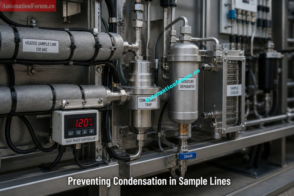

Step 4: Verify No Condensation or Moisture
One of the major concerns with analyzer sample systems is condensation.
Moisture inside tubing can dissolve process gases, damage sensors, rust parts, and make analyzers give wrong readings.
Inspect the following items:
- Condensate pots
- Moisture traps
- Heat traced sample lines
- Drain systems
- Sample coolers
- Heated enclosures
- Insulated tubing
Look for water that is clearly building up inside the tubing or filter bowls.
Check that heat tracing systems are working correctly because not enough heat can cause vapor to condense inside sample lines.
Check the drain systems to make sure that the condensate removal is working well.
Problems with condensation are very important for gas analyzers, like oxygen analyzers, moisture analyzers, and infrared analyzers.

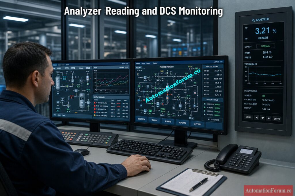

Step 5: Confirm Analyzer Reading Stabilization
Stable values from the analyzer show that the analyzer and sample system are working properly.
During inspection:
- Observe analyzer reading stability
- Check for abnormal fluctuations
- Compare readings with process conditions
- Verify DCS trending
- Compare against laboratory results if available
- Confirm analyzer warm up completion
Unstable readings may indicate:
- Flow instability
- Sample contamination
- Sensor degradation
- Condensation
- Pressure fluctuations
- Calibration drift
- Electronic faults
In the DCS, trending analysis is quite helpful for finding analyzer faults that are taking a long time to develop.

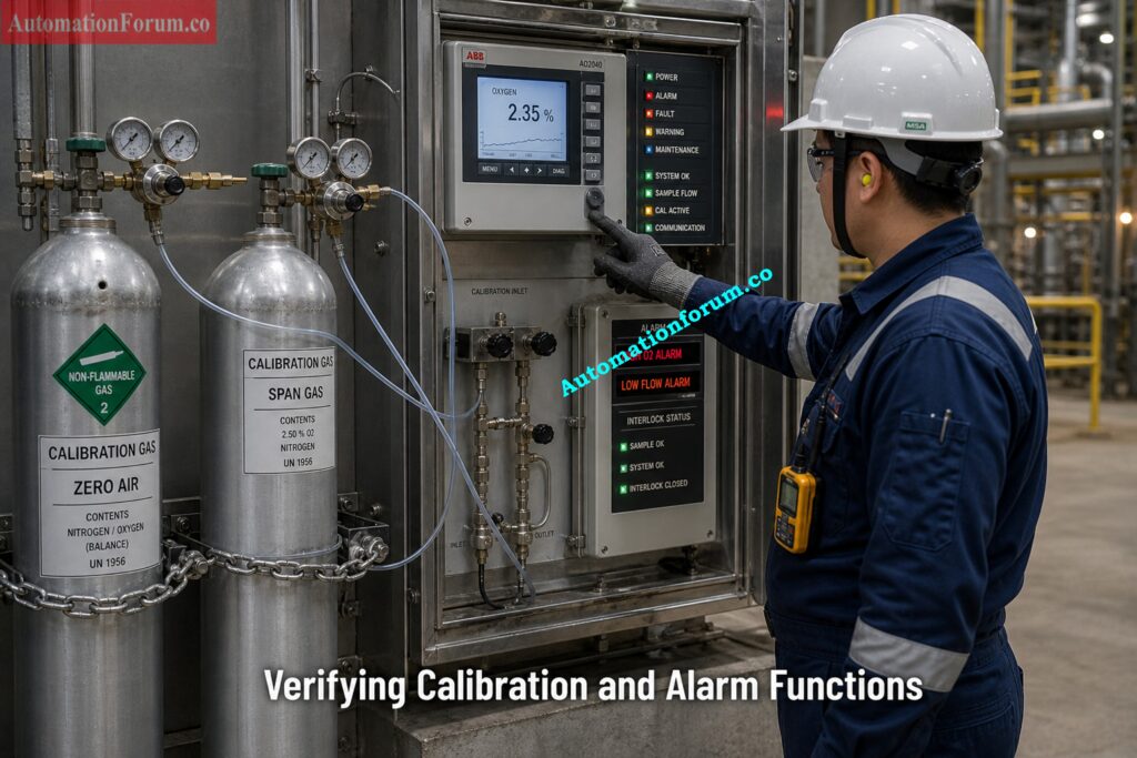

Step 7: Verify Calibration Status
Calibration verification is essential for maintaining analyzer accuracy.
Inspect the following:
- Calibration gas availability
- Calibration cylinder pressure
- Calibration due date
- Zero gas condition
- Span gas condition
- Analyzer drift
- Auto calibration sequence
Verify that calibration records are updated properly.
Excessive analyzer drift between calibrations may indicate sensor aging, contamination, or internal faults.
Calibration gases must be stored safely and within valid certification periods.

- High alarms
- Low alarms
- Analyzer fault alarms
- Sample flow alarms
- Shelter gas detection alarms
- Interlock actions
- Signal transmission to DCS or PLC
Confirm alarm annunciation and proper control system response.
Faulty analyzer alarms may prevent operators from detecting dangerous process conditions.

Common Sample Flow Problems in Analyzer Systems
The following issues are commonly identified during routine analyzer inspections:
- Low sample flow
- Blocked filters
- Condensation in tubing
- Sample leakage
- Regulator instability
- Analyzer drift
- Rotameter malfunction
- Heat tracing failure
- Sensor contamination
- Unstable analyzer readings
- Delayed analyzer response
- Calibration gas leakage
- Moisture trap overflow
- Corroded tubing connections
Many analyzer problems originate from poor sample conditioning rather than the analyzer itself.

Real Field Case Studies of Analyzer and Sampling System Failures
Case Study 1: Low Sample Flow Causing Delayed Analyzer Response
The hydrogen analyzer equipment in a refinery revealed a delayed response when the process changed. The investigation found that the sample flow rate had reduced because the coalescing filter was only partially blocked.
The sample travel time increased because of less flow, which made the analyzer take 3 to 5 minutes longer to respond. This caused the operator to take longer to act when the reactor was disturbed.
The analyzer response went back to normal once the filter was changed and the flow was fixed.

Case Study 2: Condensation Causing False Gas Analyzer Reading
An oxygen analyzer at a gas processing plant began to display readings that were unusually low. The inspection revealed moisture inside the sample line because the heat tracing didn’t work.
The condensed liquid took in some of the gas components, which made the concentration that actually reached the analyzer lower. Because of this, the oxygen measurements were wrong and too low.
Condensation is a big problem for sampling systems since it affects the makeup of the sample and makes the analysis wrong.
The analyzer values stabilized once the heat tracing was restored and the condensate was drained.

Analyzer and Sampling System Inspection Checklist
| Inspection Item | Check Description | Status | Remarks |
| Analyzer power supply | Verify power healthy | OK / Not OK | |
| Analyzer display | Check display and diagnostics | OK / Not OK | |
| Sample flow | Verify normal rotameter reading | OK / Not OK | |
| Filters | Check cleanliness and pressure drop | OK / Not OK | |
| Pressure regulator | Verify stable outlet pressure | OK / Not OK | |
| Condensation | Confirm no moisture accumulation | OK / Not OK | |
| Heat tracing | Verify heater operation | OK / Not OK | |
| Moisture trap | Inspect drain condition | OK / Not OK | |
| Tubing condition | Inspect corrosion and damage | OK / Not OK | |
| Leak inspection | Verify leak free fittings | OK / Not OK | |
| Analyzer readings | Confirm stable measurement | OK / Not OK | |
| Calibration status | Verify calibration validity | OK / Not OK | |
| Alarm condition | Check alarm functionality | OK / Not OK | |
| Communication | Verify DCS communication | OK / Not OK | |
| Shelter ventilation | Confirm proper ventilation | OK / Not OK | |
| Exhaust system | Verify vent line operation | OK / Not OK |
Common parts of industrial inspections are checking the flow of rotameters, the temperature of heat traced tubing, the amount of condensate, analyzer readings, purge systems, and calibration checks.

Advanced Diagnostics and Predictive Monitoring for Analyzer Systems
Modern process facilities are using more and more advanced diagnostics and predictive monitoring methods to make analyzers more reliable and cut down on unscheduled downtime.
DCS Trend Analysis for Analyzer Health
In the Distributed Control System, you should always keep an eye on the analyzer readings. Trending can help you find problems with delayed responses, steady drift, or unexpected spikes.
For example:
- Gradual drift indicates sensor aging or contamination
- Sudden spikes indicate flow or pressure instability
- Flat signals indicate sample blockage
Differential Pressure Monitoring Across Filters
Installing differential pressure indicators on filters can help you find clogs before they impair the functioning of the analyzer.
An increase in pressure drop means that contamination is building up, which can slow down the flow of samples and make measurements less stable.
Low Flow Alarm Strategy
You can use low flow switches or transmitters to set off warnings when the flow of samples decreases below a certain level.
This stops the analyzer from working when the sample circumstances are not right.

Running Inspection Checklist for Analyzer and Sampling System in Process Industries Excel Sheet
Download this Excel based analyzer inspection checklist to verify sample flow, filters, regulators, tubing, calibration, alarms, and system health, ensuring accurate measurements, reduced downtime, and reliable process operation.
