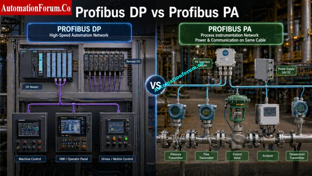

Difference Between Profibus DP and Profibus PA
In real engineering projects, Profibus is usually discussed in two main forms. Profibus DP is used for fast automation communication, remote I O, and machine control. Profibus PA is used for process instrumentation, especially where field devices need communication and power over the same cable.

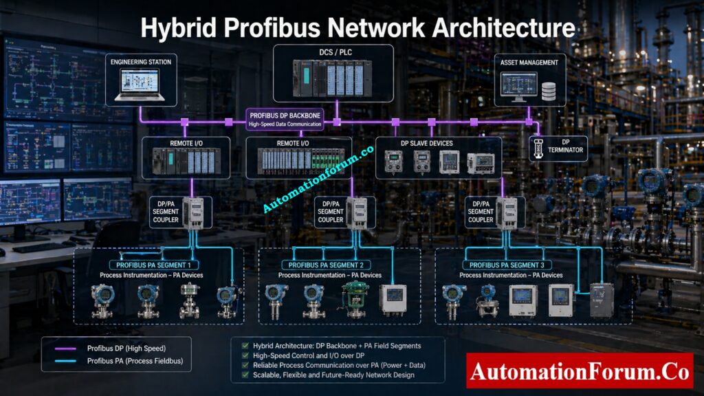

What is a Hybrid Profibus Network Architecture
A hybrid Profibus system combines both approaches using a DP backbone and a PA segment through a coupler or segment coupler.
The key point is simple. Profibus is not only about connecting devices. It is about designing a stable segment that works reliably under real field conditions. That is why Profibus segment calculation is so important.

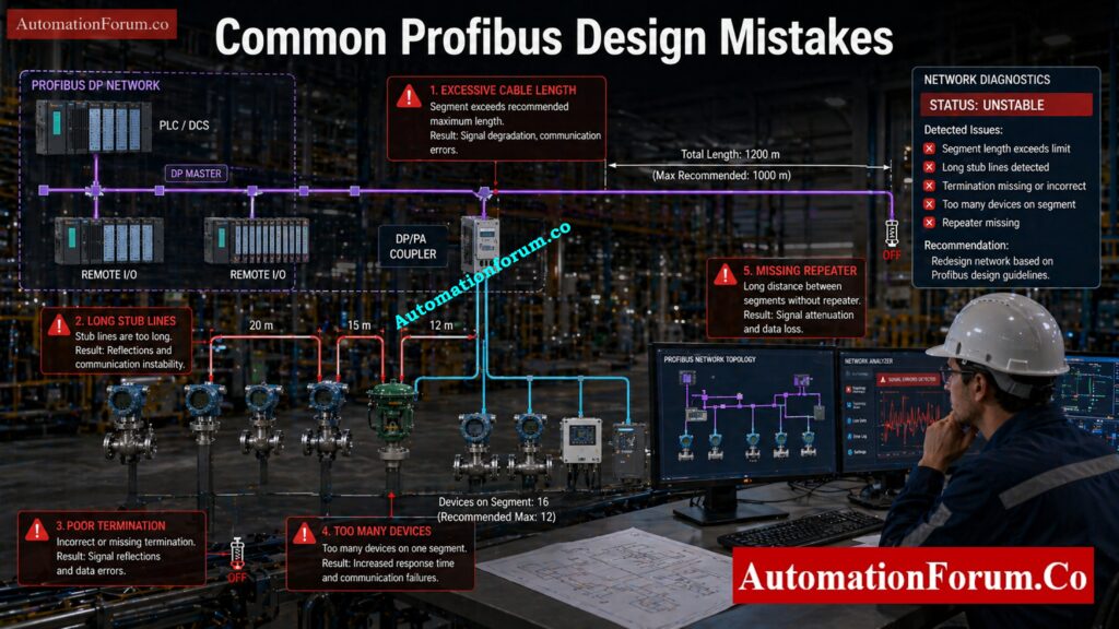

A poor design can create communication dropouts, intermittent faults, signal reflections, unstable device behavior, and repeated maintenance calls.

Effect of Stub Lines on Signal Integrity
Profibus may look simple in a block diagram, but the real plant environment makes design decisions much more sensitive. Cable length, baud rate, device loading, stub length, termination, grounding, shielding, and environment all affect network stability.
Impact of Baud Rate on Profibus Cable Length
One of the most important factors is baud rate. A higher baud rate gives faster communication, but it reduces maximum cable length. That means a network running at a high speed cannot be wired the same way as a low speed network. This is one of the most common reasons why Profibus DP cable length must be checked carefully.
Device Count and Network Loading Challenges
Another major issue is device count. Even if the cable is within length limit, too many devices on one segment can create loading problems and make troubleshooting difficult. Stub lines can also create reflections and signal degradation. In plant conditions, these issues may not appear immediately during startup, but later they can create unstable operation.

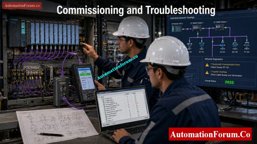

Profibus Commissioning and Validation Checks
During commissioning, the engineer verifies that the installed network matches the original design assumptions. If the segment is outside limits, corrections can be made before handover.
Troubleshooting Profibus Communication Issues
The calculator helps figure out if the problem is with the cable length, the device loading, the stub lines, or the coupler choices while troubleshooting. This is quite helpful when the plant is already running and the team has to check the engineering quickly.

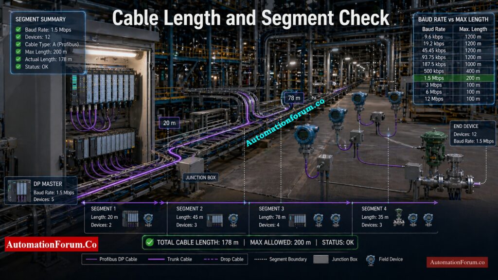

Profibus DP Cable Length vs Baud Rate Chart
In practice, the allowable cable length depends on baud rate. Lower speeds allow longer cable runs, while higher speeds require shorter distances. Typical guidance includes around 1200 meter for low speed operation, around 400 meter at 500 kbit/s, around 200 meter at 1.5 Mbit/s, and around 100 meter at higher speeds.

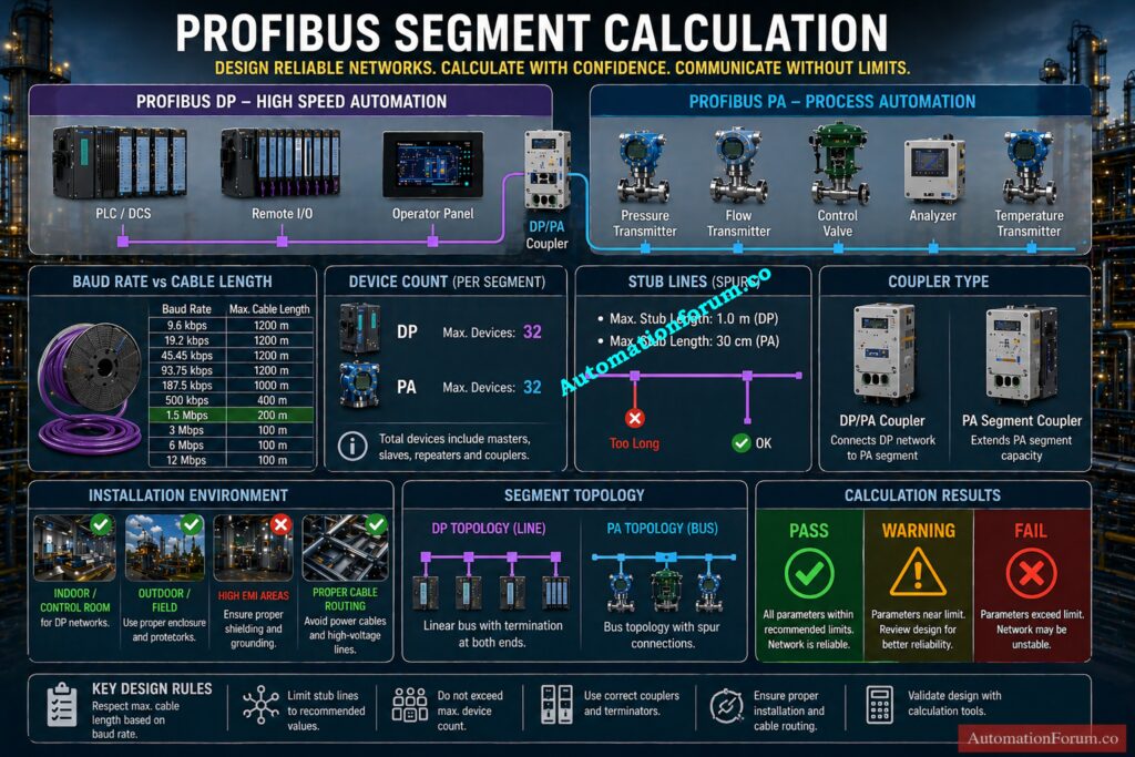

Detailed Explanation of Profibus Segment Calculator Inputs
The strength of your calculator is that it uses practical engineering inputs instead of abstract theory. Every field on the form has a clear purpose and helps the engineer reach a reliable design decision.
Profibus Type (DP, PA, Hybrid)
The first input is Profibus type. This can be DP, PA, or hybrid DP with PA coupler.
Profibus DP is the preferred choice for fast communication and remote I O. Profibus PA is the preferred choice for process instrumentation in plants where devices are distributed over long distances. Hybrid architecture is useful when a DP backbone feeds PA field segments.
Application Type and Industry Conditions
Application type matters because each industry creates different installation challenges. A manufacturing plant, a refinery, a power plant, and a hazardous area do not have the same noise level, cable routing, or maintenance conditions.
Commission Field Devices Without Rookie Mistakes: Step-by-Step Guide for Installing and Commissioning HART and WirelessHART Devices for Engineers and Technicians
Baud Rate Selection for Profibus DP
Baud rate is one of the most important values in Profibus DP cable length calculation. Higher speed means shorter allowed length. Lower speed means longer segment reach. This trade off is central to Profibus design.
Cable Type (Type A vs Type B)
Cable type affects signal quality and segment length. Your calculator includes Type A and Type B selection, which is useful because different cable families have different electrical behavior and distance capability.
Devices per Segment and Total Devices
This field checks the device loading on a segment. A segment with too many devices may still be connected electrically, but performance and reliability can suffer.
This is important for larger networks where multiple segments exist. Even if one segment looks fine, the total device population must still remain within the network limit.
Trunk Length Calculation
Trunk length is the main backbone length of the segment. This is the primary value that determines whether repeaters or segmentation are needed.
Stub Lines and Stub Length Considerations
Stub lines are a frequent source of communication issues. Long stubs increase the chance of reflections and waveform distortion. Your calculator checks both the number of stubs and the average stub length, which is very practical for field use.
PA Device Power Loading
In Profibus PA, power loading matters because the same line carries both communication and supply. Excessive current demand can lead to voltage drop and segment instability.
Coupler Type Selection
The coupler type determines how far the PA segment can be extended. A standard coupler and an extended range coupler do not provide the same design capability.
Installation Environment Impact
The environment input is very useful because industrial noise, outdoor exposure, and hazardous area conditions influence cable routing, shielding, grounding, and fault risk.

Maximum Cable Length Validation
This output shows whether the selected baud rate and cable type can support the planned installation. It is one of the most important outputs for Profibus segment calculation.
