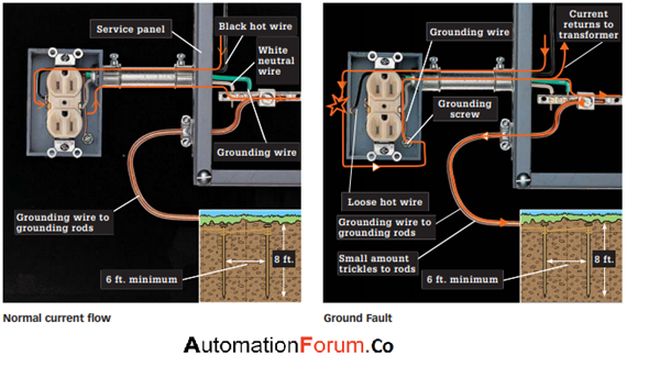

What is a grounding system
In an electrical network, the circuitry which provides a path between the parts of the circuit and the ground is known as the grounding system. The ground is essential for the reliable operation of the electrical equipment such as generator, transformer, power system tower… Electrical equipment must be grounded they are grounded in such a way that the equipment voltage will be the same as the ground and it is called as equipment grounding. In case of power transmission and distribution grounding is inevitable, the towers in the transmission system are grounded by an earth electrode.

Components related to grounding
Grounded conductor
A system or circuit conductor which will be intentionally grounded, it is also known as the grounded conductor on a neutral wye system.
Grounding conductor
It is a conductor which is used to connect equipment or the grounded circuit of a wiring system to a grounding electrode or electrodes
Grounding electrode
It is a device which is used to establish an electrical connection to the earth
Grounding electrode conductor
It is a conductor which is used to connect the grounding electrode to the equipment grounding conductor, to the grounded conductor, or to both at the service
Grounding conductor equipment
It is the conductor which is used to connect the non-current carrying metal parts of the equipment
