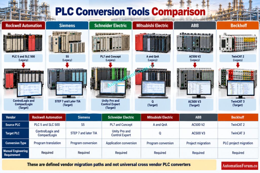

PLC Conversion Tools Comparison
VendorToolSource PLCTarget PLCConversion typeMain capabilityManual work requiredTypical application
Rockwell AutomationLogix translation toolsPLC 5, SLC 500ControlLogix, CompactLogixProgram translationLogic conversionHighLegacy Rockwell modernization
SiemensS5 and S7 converterS5STEP 7 and later TIA migrationProgram conversionSTEP 5 conversionHighS5 modernization
Schneider ElectricApplication convertersPL7, ConceptUnity Pro and Control ExpertApplication conversionProgram conversionHighLegacy Schneider migration
Mitsubishi ElectricPLC Type ChangeA, QnAQProgram conversionLogic conversionMedium to highMitsubishi modernization
ABBAutomation Builder conversionAC500 V2AC500 V3Project migrationProject conversionMediumAC500 modernization
BeckhoffTwinCAT converterTwinCAT 2TwinCAT 3Project migrationPLC and system migrationMediumMachine modernization
These tools should not be interpreted as universal cross vendor PLC converters. Official vendor solutions generally support defined source and target platforms within their own ecosystems.

Common examples include Rockwell translation tools, Siemens conversion tools and Schneider Electric UMAC.
Mitsubishi Electric, Honeywell and Beckhoff also provide specific PLC migration or conversion solutions.
A universal automatic Siemens to Rockwell conversion should not be assumed for industrial applications.
The program normally requires detailed analysis, logic mapping, manual conversion and functional validation.

Vendor supplied PLC conversion tools can significantly reduce engineering effort during PLC modernization, but they should never replace engineering judgment.
Rockwell Automation, Siemens, Schneider Electric, Mitsubishi Electric, ABB and Beckhoff provide defined migration or conversion paths for supported legacy platforms. Their tools can accelerate program translation and project migration, but hardware differences, unsupported instructions, communications, safety functions, control loops and process specific logic still require experienced engineering review.
For a successful PLC migration, the correct approach is to use the conversion tool as an engineering accelerator, then validate the resulting system through simulation, FAT, SAT, loop checks and controlled commissioning.
