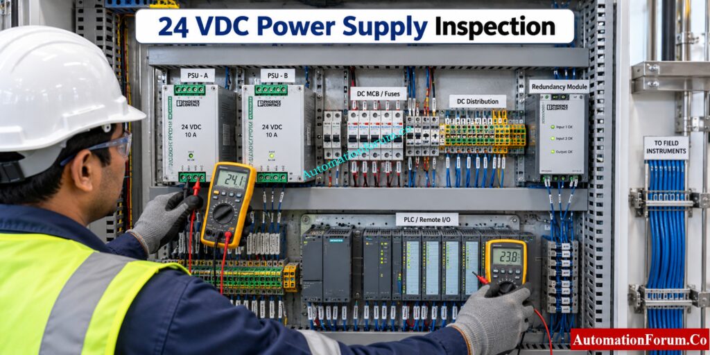

How to Check a 24 VDC Power Supply for Instrumentation Systems
How to Measure 24 VDC Power Supply Output Voltage
24 VDC is widely used for instrumentation and control equipment because many field instruments, I/O modules, relays, solenoids, and associated devices are designed around DC control power.
How to Check 24 VDC Voltage at Downstream Instruments
During a 24 VDC power supply inspection, measure the voltage directly at the power supply and then check representative downstream loads.
This second measurement is important.
Know Which Safety System Fits Your Process: ESD vs SIS Difference When to Use Each and Practical Engineering Guide
What Causes Low Voltage at a Downstream Instrument?
Suppose the power supply output is healthy, but a remote I/O panel shows a lower voltage. The engineer should investigate the distribution path. This could be due to a cable run that is too long, a conductor that is too small, loose terminals, over loaded circuits, broken cables or bad connections.
How to Identify Excessive Voltage Drop in a 24 VDC Circuit
The effect of voltage drop depends on the connected device. Some equipment may generate a diagnostic alarm, while another device may restart, behave intermittently, or stop operating.
Do not apply a universal acceptable voltage value to every installation. The correct limits should come from the equipment datasheet, project specification, approved drawings, and vendor documentation.

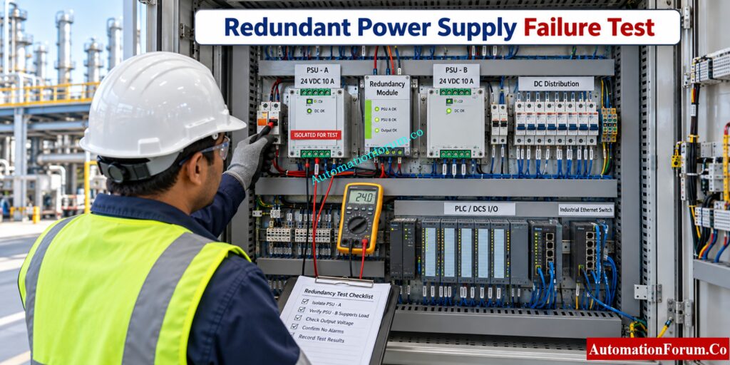

Step 5: Perform a Controlled Power Supply Failure Test
Under controlled settings, if the approved commissioning method permits, disconnect or isolate one power source.
The remaining source should continue supplying the required load without causing an unacceptable interruption.
This test must never be improvised on an operating safety critical system.

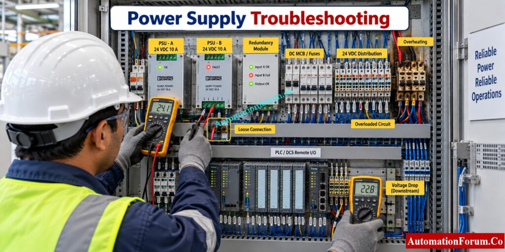

Common Problems Found During Running Power Supply Inspection
Several problems appear repeatedly during commissioning and maintenance.
| Problem | Possible cause | Investigation |
| Low DC voltage | Overload, voltage drop, faulty supply | Check load and distribution voltage |
| Excessive voltage drop | Cable resistance or loose connection | Measure at source and load |
| Unequal load sharing | Configuration or module issue | Check redundancy module and wiring |
| Overloaded supply | Additional or unexpected loads | Review connected load |
| Failed redundant module | Module fault or wiring issue | Check diagnostics and connections |
| Loose terminals | Poor installation or vibration | Inspect and tighten according to procedure |
| Overheating | High load or poor ventilation | Check temperature and cooling |
| Blown fuse | Short circuit or excessive load | Investigate downstream circuit |
| Missing alarm | Wiring or configuration problem | Perform alarm verification |
| Redundancy not transferring | Incorrect configuration or failed module | Check architecture and test procedure |
A common commissioning mistake is replacing an instrument immediately after observing an undervoltage alarm. First check the voltage at the instrument terminals and trace the distribution path back toward the power source.

Safety Precautions During Power Supply Redundancy Testing
- Redundancy testing might entail deliberately disconnecting a power source. This is a possible risk if the system is safety sensitive or is augmenting an operational procedure.
- Testing should therefore follow the approved procedure, risk assessment, permit requirements where applicable, system owner approval, operations coordination, electrical safety requirements, and vendor instructions.
- Do not perform uncontrolled live electrical work simply to verify redundancy. If the test cannot be performed safely under the approved operating conditions, it should be planned for an appropriate commissioning or maintenance window.

How can I test if my PSU is bad?
Measure the input and output voltage and compare the reading with the manufacturer’s stated values under real load.
Also check for overheating, odd noise, unstable output, alarms, excessive ripple and sudden shutdowns.
How to check power supply in system?
Measure the voltage at the output of the power supply and at downstream equipment at typical points while the system is running.
Both readings are compared to identify voltage loss, loose connections, overloaded circuits or distribution faults.

How to test a 24V power supply?
Measure the DC voltage at the output of the 24 VDC power source and compare to the equipment manufacturer’s indicated operating range.
Then test the voltage at the down stream loads to see whether you have distribution losses, too much load or connection problems.

How do you check redundant 24 VDC power supplies?
Check source status, output voltage, load condition, redundancy module health, alerts and monitoring as per approved system architecture.
Where permitted, isolate one source under controlled conditions and verify that the other source will carry the needed load.
What happens when one redundant power supply fails?
In a good redundant design, the remaining source should continue to provide the appropriate load as per the system design.
The failing source should also produce the expected local or system diagnostic indication.
How do you verify DCS power supply redundancy?
Review DCS power architecture. Identify redundant sources. Check normal readings and diagnostics and verify associated alarms.
Perform a controlled source failure test and check the needed operation where the commissioning procedure permits.
