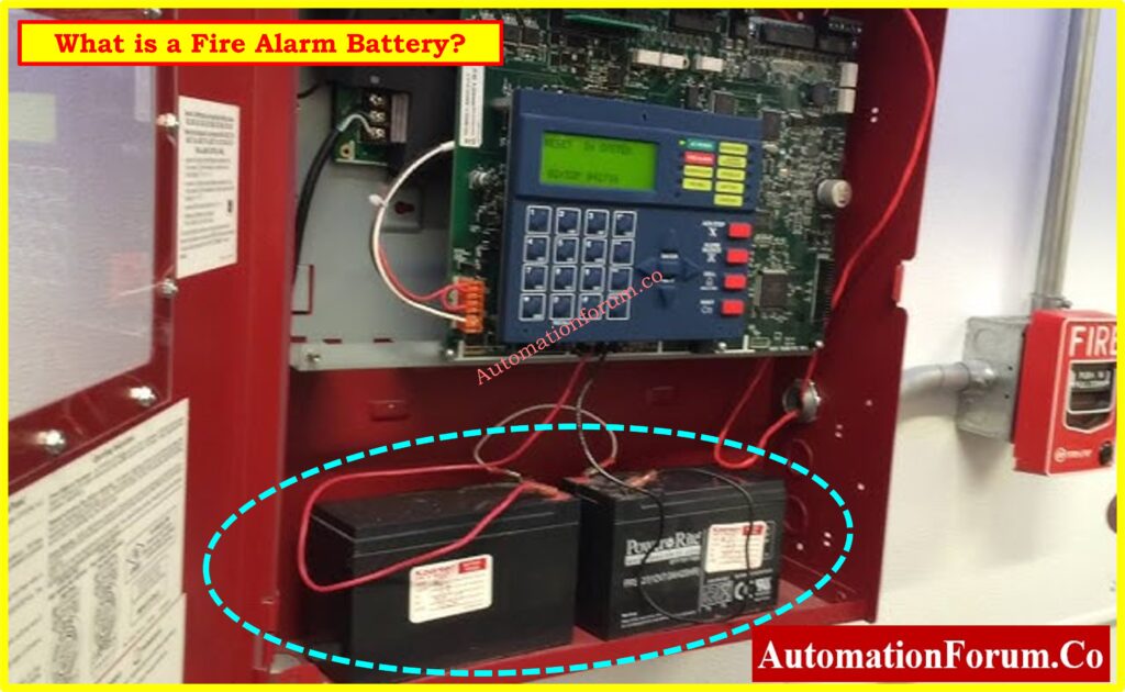

What is a Fire Alarm Battery?
A fire alarm battery is a backup power source for fire alarm systems that keeps them working even when the main power goes out. It is very important for keeping people safe, especially during power outages, fires, or electrical problems.
  • Standby Power: This keeps the fire alarm panel and linked equipment working in normal monitoring mode for 24 to 72 hours.
  • Alarm Power: Gives enough power to run high-current devices like sirens, strobes, relays, and communication modules during emergency alerts, which usually last between 5 and 30 minutes.
  • Required by important fire safety standards as NFPA 72, BS 5839, IS 2189, and EN 54-4.
  • Failsafe Protection: Makes sure that fire detection, evacuation, and emergency actions can still happen even if the power goes out because of a fire or a blackout.

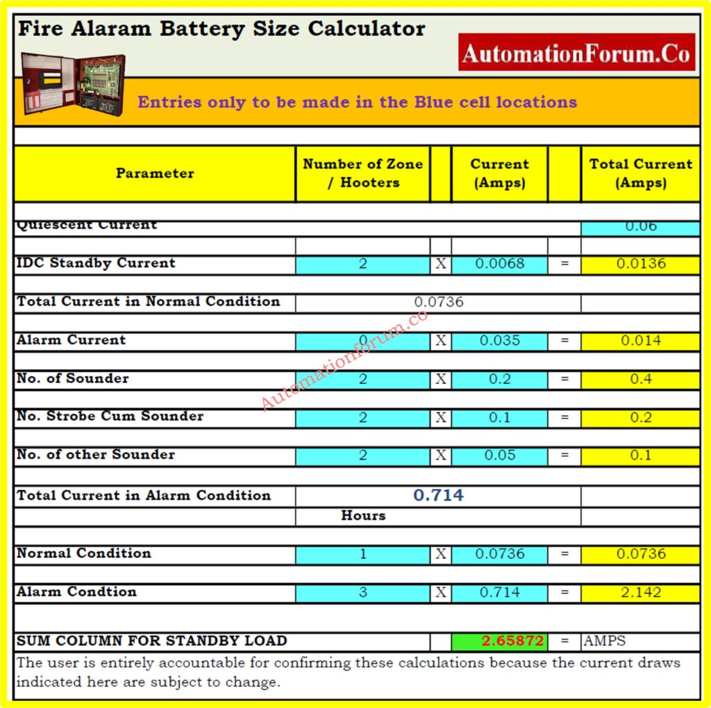

To figure out the size of the fire alarm battery, you need to find out how much energy (in ampere-hours, Ah) the system needs to work when it is in standby and when it is sounding an alarm in case of a power loss. This is the general formula for the calculation:
Battery Size (Ah) = [(Standby Current × Standby Time) + (Alarm Current × Alarm Time)] × Safety Factor
Steps:
  1. Find the standby current (sometimes called quiescent current), which is the current that flows when the device is not in use.
  2. Find the alarm current, which is the current that flows when the system is fully alarmed.
  3. Set the times: 24 to 72 hours for standby and 5 to 30 minutes for alarm.
  4. Add a safety margin, which is usually 20%, to account for aging, temperature changes, and future load increases.
The result lets you choose the right size sealed lead-acid (SLA) or Li-ion battery that will work safely and according to code.
The size of the battery you need depends on:
  • The total amount of power used while waiting (in amps or milliamps)
  • The alert load, which is usually significantly higher than the standby load
  • Time spent on standby (usually 24 hours or more)
  • Length of alarm (usually 5 or 30 minutes)
  • A safety buffer, which is usually 20%
Example:
If your fire alarm panel uses 0.5A in standby for 24 hours and 1.5A in alarm for 0.5 hours,
Battery Size = (0.5 × 24) + (1.5 × 0.5) = 12 + 0.75 = 12.75 Ah
With 20% margin: 12.75 × 1.2 = 15.3 Ah → Use a 17Ah or 18Ah battery
