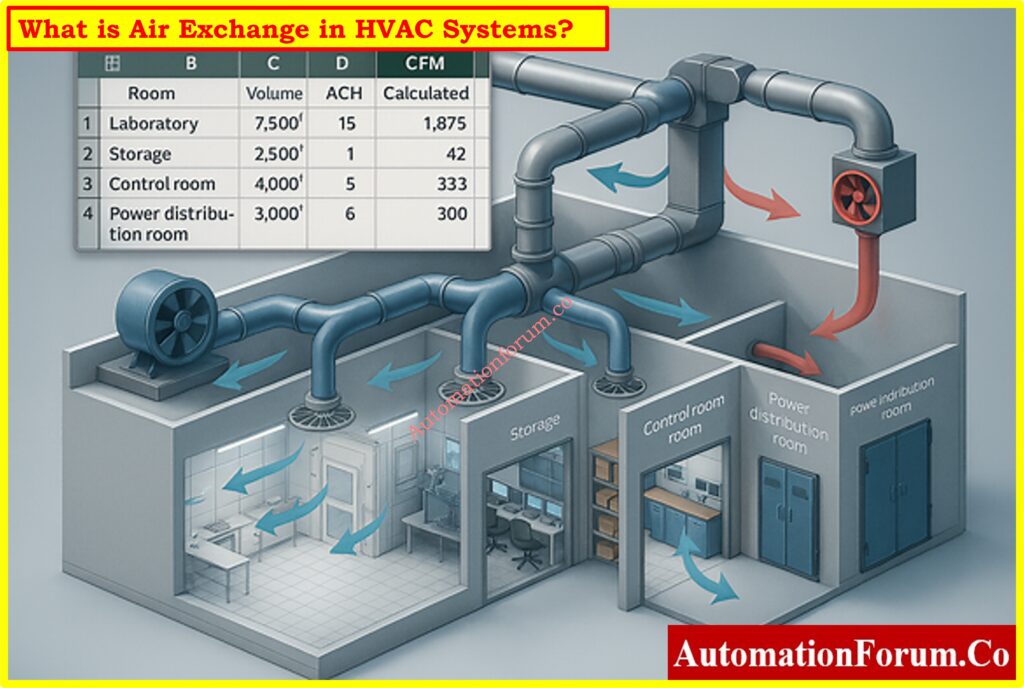

Design engineers often use customized tools to make this calculation easier. This post talks about a thorough Air Exchange Calculation Excel Tool that is made just for HVAC use in process industries. The tool is meant to help engineers quickly figure out how much airflow in cubic feet per minute (CFM) is needed based on the size of the room and the ACH needs.

So, by entering in the room’s size and ACH, the tool automatically figures out how many CFM are needed.

  1. Open the Excel Tool.
    The first worksheet has the calculator and cells for input and output..
  2. Enter Room Dimensions.
    • Example: Length = 25 ft, Width = 20 ft, Height = 12 ft.
  3. Enter ACH.
    • For a laboratory, select an ACH of 20 (within the 12–60 range).
  4. Review Calculations.
    • Room Volume = 6,000 ft³.
    • Minutes per Change = 60 ÷ 20 = 3 min.
    • Required CFM = 6,000 ÷ 3 = 2,000 CFM.
  5. Compare with Reference Table.
    • Ensure the selected ACH is appropriate for the application.
  • Dimensions: 25 × 20 × 12 ft = 6,000 ft³.
  • ACH selected: 20.
  • Minutes per Change: 60 ÷ 20 = 3 min.
  • Required CFM: 6,000 ÷ 3 = 2,000 CFM.
The HVAC system must supply at least 2,000 CFM to maintain safe air quality in the laboratory.
