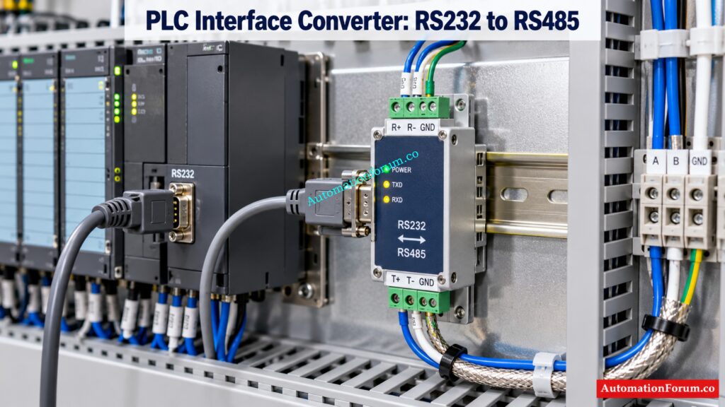

What Is a PLC Interface Converter?
A PLC interface converter adapts the electrical interface or physical communication medium between two devices. It does not necessarily translate the communication protocol used by those devices.
For example, an RS232 to RS485 converter will allow equipment with an RS232 interface to interact via an RS485 interface, if their communication requirements are suitable. Similarly an Ethernet to fiber optic media converter alters the physical transmission medium but does not instantly translate the industrial protocol.
Typical applications include interfacing legacy PLCs, engineering access to serial devices and extending communication links in electrically loud production environments.
Advantages: Easy installation, compatibility with existing equipment, less interface replacement .
Limitations: A simple interface converter cannot fix incompatible application protocols, wrong register mapping or data representation.
Before installation, engineers should evaluate interface compatibility, transmission distance, electrical isolation, grounding, and shielding and termination requirements.

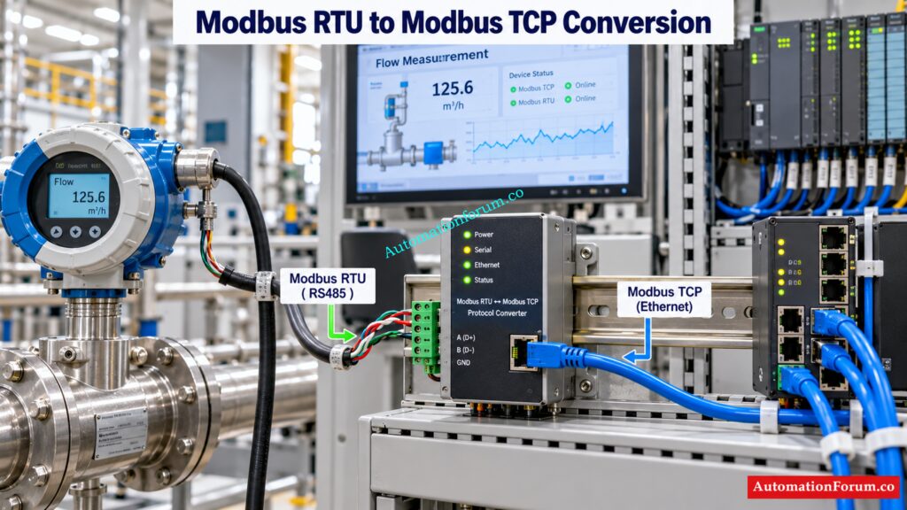

Modbus RTU to Modbus TCP Converter Example
Consider a flow meter connected to a PLC through RS485 using Modbus RTU. A new SCADA application needs to retrieve the flow measurement through Modbus TCP.
The protocol converter can take serial requests (or poll the flow meter depending on the configuration) and return the required data over ethernet. Engineers have to define device addresses, register mapping, communication responsibilities, function codes, and data representation.
The exact configuration depends on whether the converter is a Modbus TCP server, Modbus RTU master or other supported combinations.
A protocol converter is appropriate when the main problem is communication incompatibility rather than a physical connection alone.

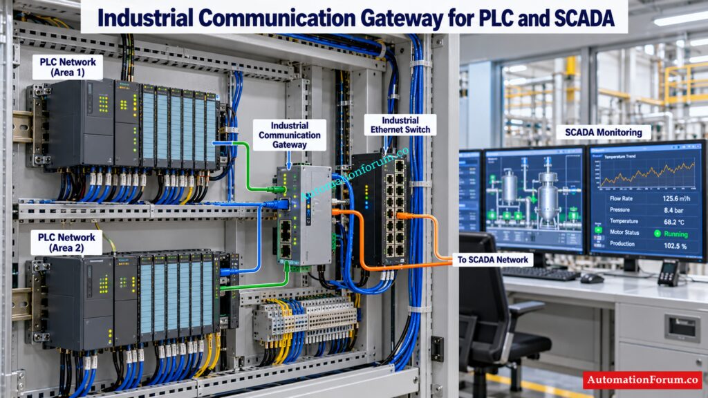

What Is an Industrial Communication Gateway?
An industrial communication gateway connects devices, networks, automation systems, or higher level applications. Protocol translation may be one of its functions, but some gateways also support data aggregation, data normalization, buffering, diagnostics, and connectivity to industrial data platforms.
For example, a gateway may collect selected operating data from several PLCs and publish it to a monitoring application using OPC UA or MQTT, where supported.
In a plant modernization project, this can help deliver production information to a supervisory or industrial data system without replacing every existing PLC.
However, gateway capabilities vary considerably. Some devices provide simply a minimal protocol bridge, others support numerous interfaces, data processing, remote setup or other security controls.
Engineers need to verify supported protocols, device capacity, update rates, buffering behavior, control of access, and compliance with the intended SCADA or DCS architecture before making a selection.
