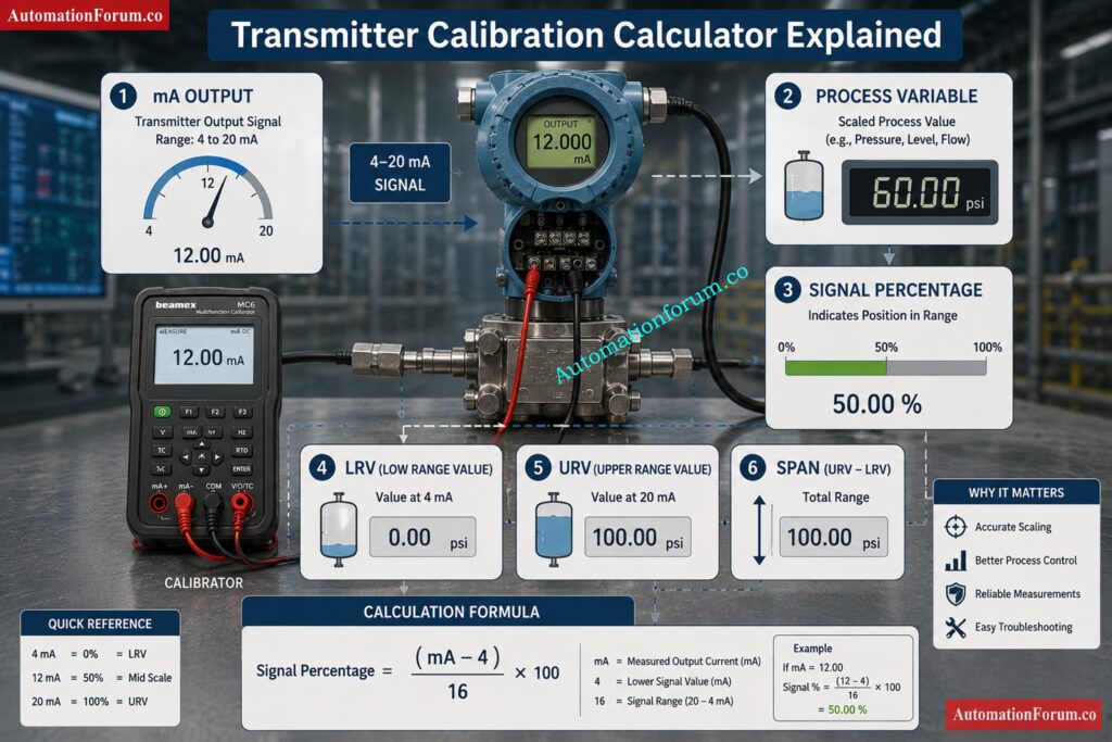

Formulas Used in Transmitter Calibration Calculation
The first formula is used to convert current to signal percentage.
Signal percentage = (mA minus 4) divided by 16 times 100
This works because the active signal range is 16 mA wide. The live zero at 4 mA gives 0 percent, the midpoint at 12 mA gives 50 percent, and the full scale at 20 mA gives 100 percent. That proportional behavior is what makes 4 to 20 mA so useful in industrial control systems.
Improve instrument accuracy calculations with one quick check: Instrument Accuracy Calculator
The second formula is used to estimate span.
Span = PV divided by signal percentage divided by 100
Once the signal percentage is known, the process value can be used to infer the full range width. This is the reverse calculation logic used by the calculator. It is useful for checking how a transmitter output relates to the engineering scale behind it.
The third formula is used to estimate LRV.
LRV = PV minus signal percentage divided by 100 multiplied by span
This identifies the lower end of the range based on the known PV and signal position. It helps the engineer understand where the measurement window begins.
The fourth formula is used to estimate URV.
URV = LRV plus span
This gives the upper end of the measurement range. Together with LRV and span, it completes the range picture for the transmitter.
Get flawless pH calibration using trusted standard solutions: pH transmitter calibration with standard solutions
ItemValue
mA output12 mA
PV5 bar
Signal percentage50 percent
Span10 bar
LRV0 bar
URV10 bar
At 12 mA, the signal is halfway between 4 mA and 20 mA. That means the transmitter is at 50 percent of range. If the process variable is 5 bar, then the full span must be 10 bar. The calculated LRV is 0 bar and the URV is 10 bar, which matches a very common pressure transmitter range. This is exactly the type of practical check that engineers use during commissioning and calibration review.

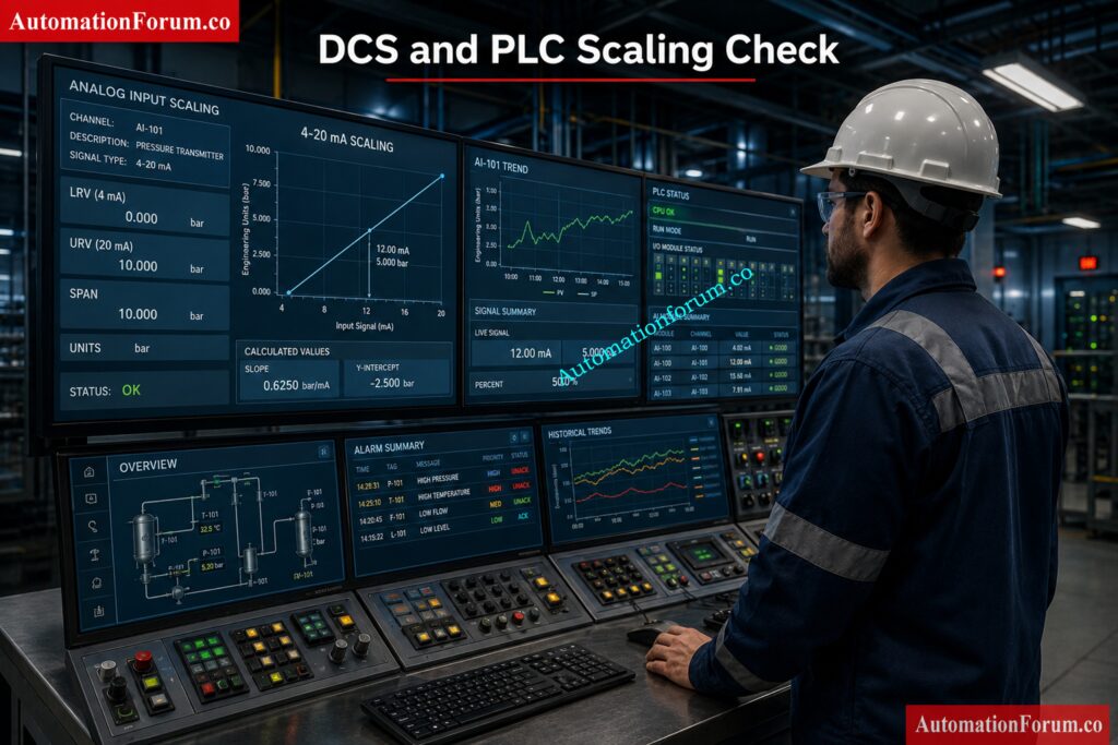

  • DCS and PLC Analog Input Scaling Verification

  • Verify that DCS or PLC scaling matches the transmitter configuration.

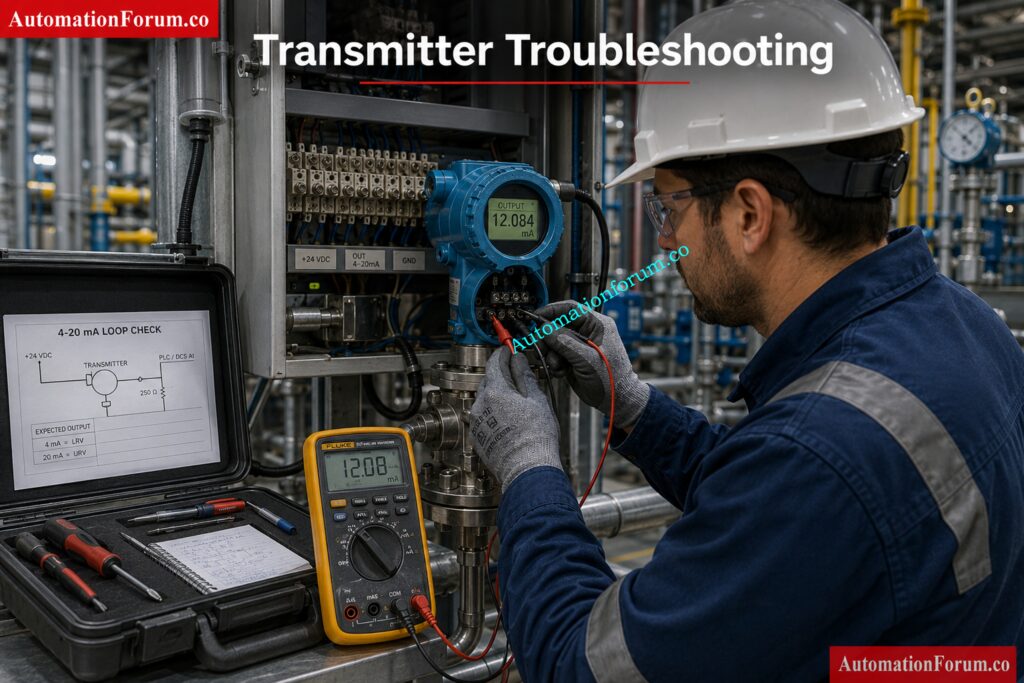

Troubleshooting Transmitter Calibration Errors
If measurement problems develop, examine the following prior to replacing the transmitter.
  • Check transmitter range settings and loop current
  • Check DCS or PLC analog input scaling
  • Check wiring, connections and power supply conditions
  • Check engineering units are consistent throughout the control system
  • Review installation reference points and zero elevation
  • Check electrical noise concerns with grounding/shielding
  • Verify calibration status and transmitter health
  • Investigate process conditions that may affect measurement stability

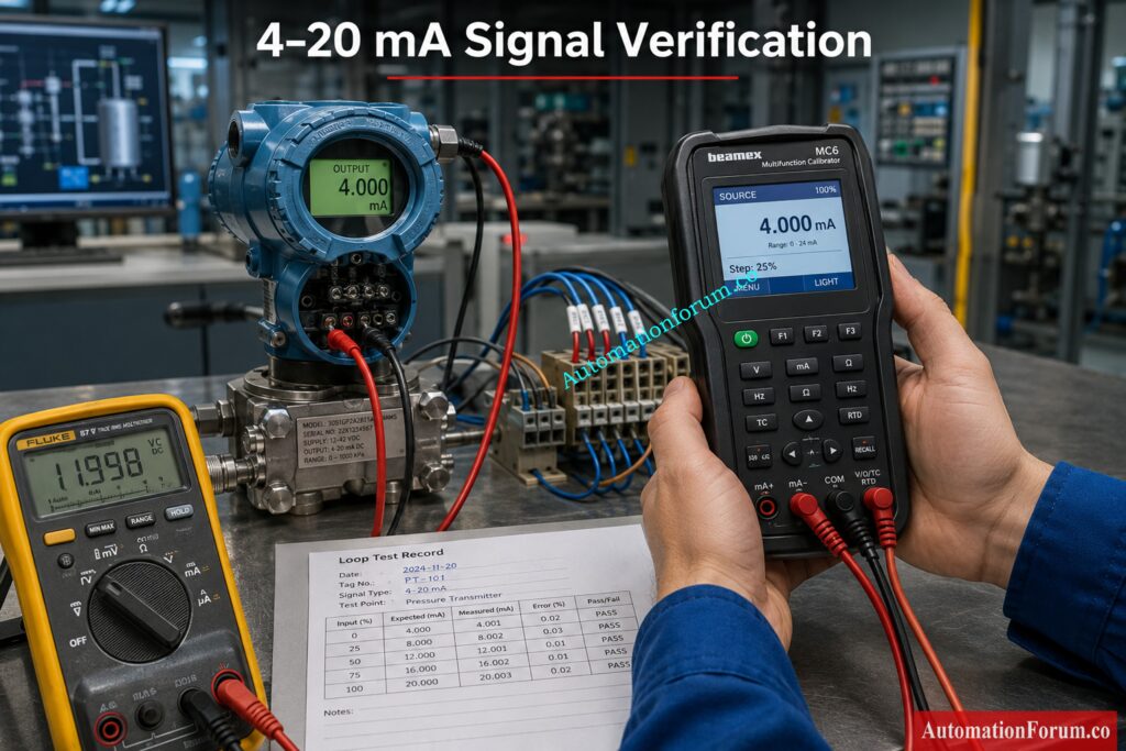

During plant startup, the engineers should check the transmitter performance and scalability of the control system.
  • Verify LRV and URV values in the configuration match design docs
  • Check voltage, polarity and wire continuity of power supply.
  • Simulate 4 mA , 12 mA and 20 mA signals
  • Check accuracy of field indication and control room display
  • PLC or DCS scaling calculation check
  • Test alarm and trip operation at setpoints as set up
  • Results of calibration and test loop
  • Get final commissioning permission prior to handover

Many applications use zero suppression or zero elevation, causing the low point to be above or below zero.
Therefore, the process value at 4 mA depends on the configured transmitter range.
Span is the difference between the upper range value and the lower range value.
It determines the entire measuring range that the transmitter has to cover.
Span changes during calibration assure the accuracy of the scaling across the full operating range.
The process variable is transformed to a proportional current signal by the transmitter.
As the PV increases the output current climbs linearly from 4 mA to 20 mA.
Start with checking the transmitter settings, loop current and engineering units.
Verify that the PLC or DCS scaling parameters are set to match the transmitter LRV and URV.
Also inspect wiring, calibration status, and alarm configurations to identify any mismatch.
