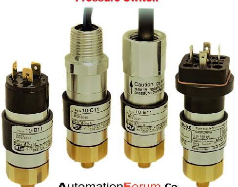

What is Pressure Switch?
Pressure switch is a device that closes the electrical contact when a certain set fluid pressure has been reached in its input. It is designed to make contact either a rise in pressure or a fall in pressure. Most pressure switch use diaphragm or bellow as a sensing element. The deflection of this sensing element is used to actuate one or more switch contact to indicate an alarm or initiate a control action. A pressure switch is consequently utilized to make sure that the operation of equipment is proper and the safety of personnel. Due to the different roles that pressure switches play in countless residential and industrial systems, variety of switches currently exist.
