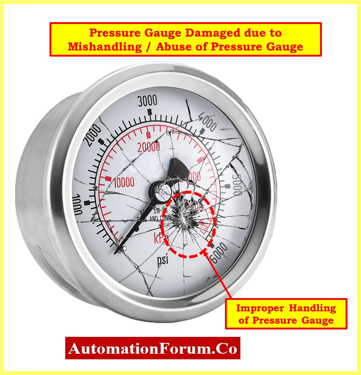

Factor No. 8: Mishandling/Abuse of pressure gauge
Mishandling and abuse of pressure gauges can lead to significant damage and compromise their functionality. Despite their appearance of sturdiness, pressure gauges are not designed to withstand rough treatment.
Visible Signs of Mishandling
- Cracked case
- Broken window
- Loss of case filling
- Crooked or bent gauge and/or process connection
Risks Created by Mishandling
- Loss of functionality
Solutions for Gauge Mishandling/Abuse:
- It is important to put in place thorough training programs to inform staff members about the risks associated with improper gauge handling.
- Discourage using gauges as footholds or handholds and stress the need of using correct handling skills.
- Make sure staff members are instructed on how to connect gauges correctly.
- To avoid damaging the casing, tighten the gauge onto the process connection using a wrench.
- When tightening NPT or G connections, use the wrench flat regions for a secure fit.
