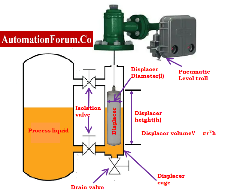

A displacer level transmitter comprises a displacer element that is hung from a hanger with a torque tube that is linked to the transmitter head. The hanger and the torque tube are both connected to the transmitter head.
The displacer element is designed and built to be heavier than the liquid in which it is being used. This ensures that the displacer element will continue to exert a downward force on the hanger even after it is completely submerged in the liquid.

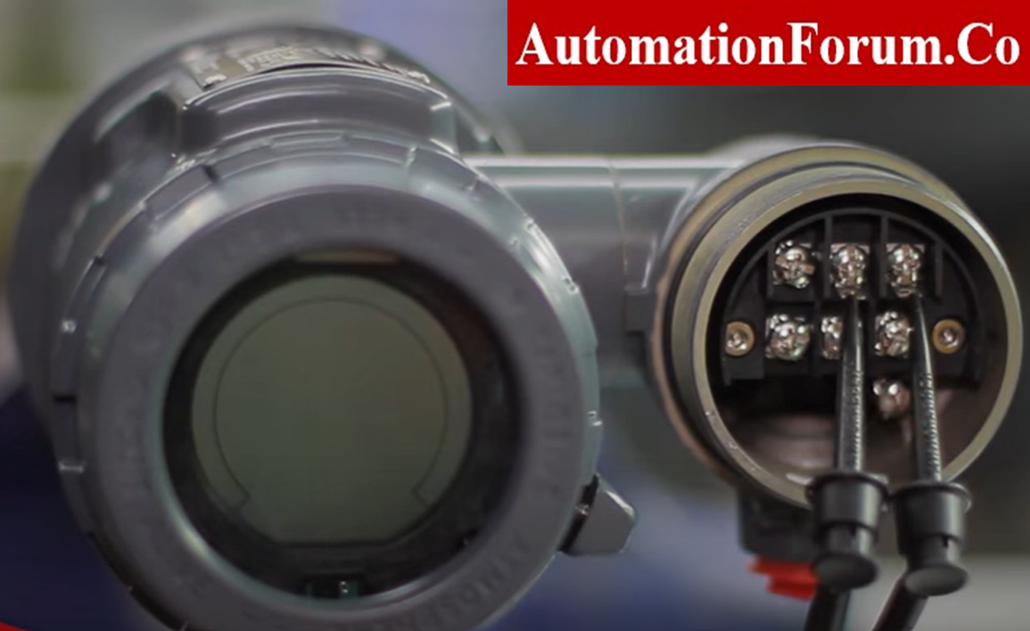

  • Connect the HART Communicator, and then check a few settings by consulting the data page. The tag number, PV, LRV, and URV are typical metrics.

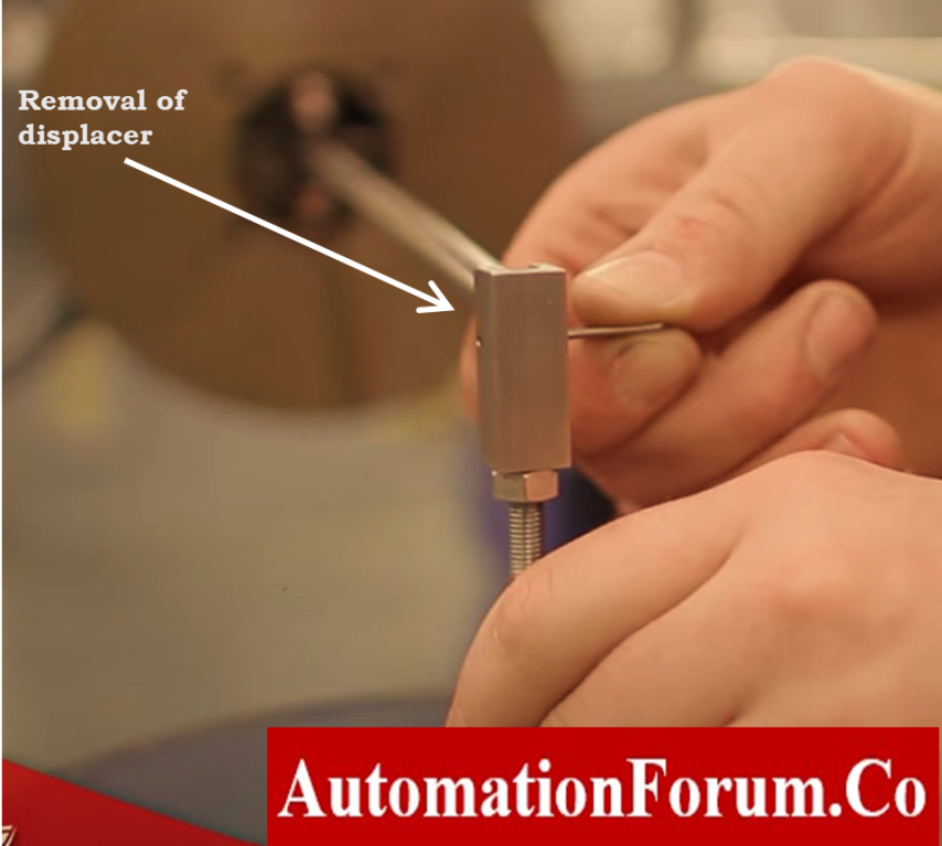

Disassembly of the controller/transmitter as well as the torque Tube Arm
  • Refer to the instruction manual for help removing the displacer from the displacer rod or the controller/transmitter and torque tube arm from the cage or vessel.
calibrate the displacer type level transmitter with weight in single liquid applications5
  • Depending on the type of sensor, there are different ways to take off the displacer or torque tube arm and the controller or transmitter that is attached to it.

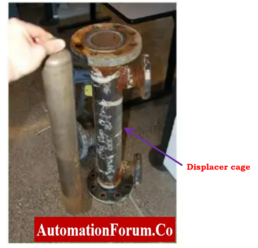

  • For a caged sensor with an equalizing connection at the top, it may be best to take the whole cage out of the vessel before taking it apart.
  • If the displacer needs to be taken off the displacer rod before the sensor assembly is taken out of the cage or vessel, there needs to be a way to hold the displacer so it doesn’t fall and break.
  • On every displacer, the spuds or stem end pieces include holes where rods or other supports may be inserted.
  • Some top-mounted sensors with long displacers can be taken off through an access hole in the head of the sensor.
  • For sensors with a travel stop, the stem end piece pins will hold the displacer on the travel stop as long as the travel stop plate is in place and the sensor head is in the right place.

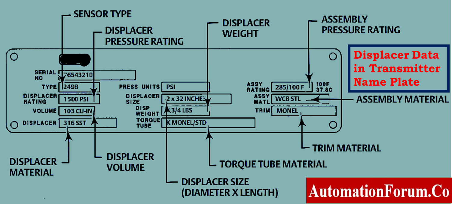

Determining the Amount of Suspended Weight:
  • Data has been previously recorded into the instrument memory, HART communication may be used to read the displacer’s actual volume and weight.
  • Otherwise, the firm plate is marked with the displacer’s true weight, and the weight of the displacer may be determined by weighing it.
  • Solve the following equation to get the total weight that has to be suspended from the displacer rod in order to simulate a certain fluid level or specific gravity condition:
  • Actual volume and weight of the displacer can be read using HART communication (if data have been previously saved into the instrument memory). Otherwise the actual volume of the displacer is marked on the nameplate and displacer weight can be measured by weighing it.

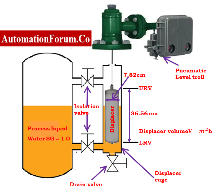

Weight Calculation with Single Liquid (water) Application
calibrate the displacer type level transmitter with weight in single liquid applications8
Displacer and Process Liquid Data:
  • W= Displacer weight in 2500 Gram
  • Displacer diameter is 7.820 Centimeter
  • Length of Displacer is 36.56 centimeter
  • Process liquid is Water
  • Specific gravity of process liquid. (Water)= 1.0
V = Volume of displacer.
So, radius of the displacer r = 7.82/2 = 3.91centimeters
Displacer Actual Volume V=?r2h
Volume V = 3.14 × r² × h
      = 3.14 × 3.91 × 3.91 × 36.56 = 1,755.049
For Zero Calibration:
  •  For zero percentage calibration attach a displacer or 2500 gram weight on the torque tube arm rod.
  • Adjust Zero with the output signal to 4 mA / 3psi(for pneumatic level troll) .
For Span Calibration:
  • For 100  percentage calibration attach the  weight = Displacer weight – {Volume X Specific gravity of the liquid(water)}
= 2500 – 1755.05 X 1
= 2500 – 1755.05
=744.95 g
  • Adjust Span with output signal of 20mA /15psi(for pneumatic level troll).
Level (%) Attached weight (gram) Transmitter o/p (mA)Transmitter o/p (psi)
0 2500 43
25 206186
50 1623129
75 11841612
100 7452015
For linearity check each 25% step increase weight by 438.8 grams
= 1755/4
=438.8g

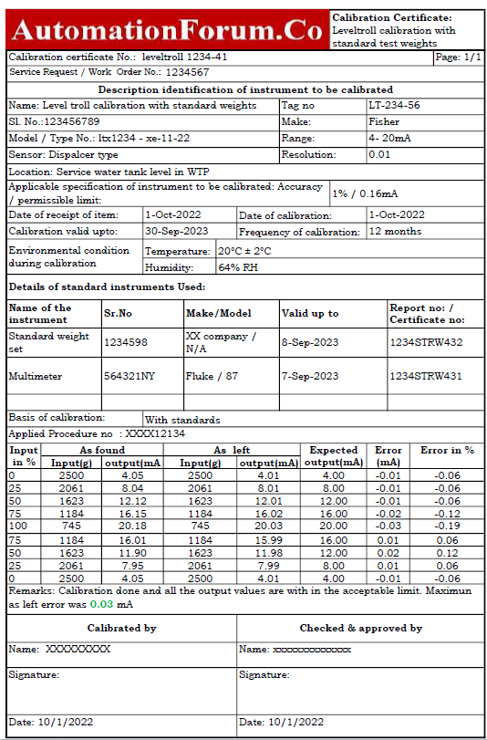

Recording calibration
  • Apply input corresponding to 0 %, 25 %, 50 %, 75 % and 100 % according to the range of Instrument in the upscale and downscale direction from the test standards.
  • If the result of the output value is not within an acceptable limit, then calibration must be performed. All the output values are within acceptable limits (+/- %), then further calibration is not required.
  • Record the resultant output values in the as found/ as left  column of blank calibration report.
  • Place calibration label on instrument once the calibration was satisfactorily done
Sample calibration report
The image that follows demonstrates that the electronic levetroll’s sample report of calibration was performed using standard test weights as the reference.
