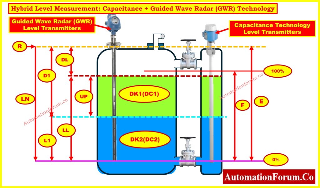

The hybrid level measurement principle, diagram explanation with important symbols and zones, probe measuring ranges, handling emulsion layers, benefits and drawbacks, probe selection, installation and calibration procedures, industry applications, and troubleshooting advice are all covered in this article.
Explaining the Hybrid Level Measurement Diagram
In order to measure the overall liquid level and the interface level between two immiscible liquids (such as water and oil), the above image shows how Capacitance + Guided Wave Radar (GWR) technologies are combined inside a process vessel.
Let’s break it down step by step:
GWR Principle in Hybrid Systems
These devices are mounted at the top of the tank and use microwave pulses to send signals down a probe. By identifying signal reflections brought on by a change in the dielectric constant, they are able to determine the overall liquid level (upper layer, such as oil).
Refer the below link to Explore the complete guide to GWR troubleshooting and maintenance
Capacitance Principle in Hybrid Systems
By examining the liquids’ dielectric characteristics, these probes determine the levels of interfaces (such as the oil-water boundary). This is especially helpful for finding conductive materials beneath hydrocarbons, like water.
Reference Markings in Diagram:
- R – Reference point (flange connection).
- LN – Probe length.
- DL – Distance to overall level.
- LL – Overall liquid level.
- D1 – Distance to interface level.
- L1 – Interface level.
- UP – Thickness of upper medium.
- E (0%) and F (100%) – Empty and full calibration points.
- DK1 (DC1) and DK2 (DC2) – Dielectric constants of upper and lower liquids.
In simple terms:
- GWR measures DL (overall level).
- Capacitance calculates D1 (interface level) by detecting dielectric changes.
Even in the presence of emulsions, this dual measurement guarantees accurate detection of both liquid layers.
