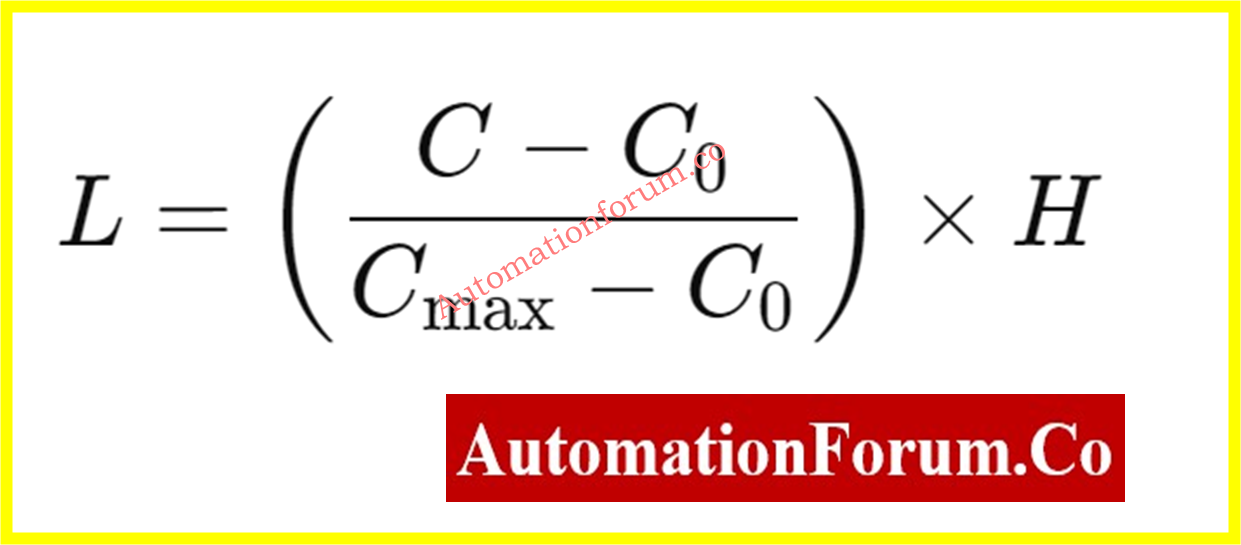

What is the formula for a capacitive level sensor?
Formula for Capacitance to Level Conversion Calculations
The formula for converting capacitance to level is:
Where:
- L = Liquid level (in meters or feet)
- C = Measured capacitance
- C0 = Capacitance when the tank level is at zero
- Cmax= Capacitance at maximum level
- H= Height of the tank (in meters or feet)
Click here for Principle, Installation and trouble shooting of capacitance type level transmitter
Example Calculation:
Suppose we have the following data:
- Capacitance measured (C) = 60 pF
- Capacitance at zero level (C0?) = 20 pF
- Capacitance at maximum level (Cmax) = 100 pF
- Height of the tank (H) = 10 meters
Now, let’s calculate the liquid level using the formula.
So, the liquid level is 5 meters.

How do you calculate capacitance in level measurement?
To calculate capacitance in level measurement, you typically need to know the capacitance when the tank is empty (C0?), the capacitance at maximum fill (Cmax), and the measured capacitance (C) at any given time. The level (L) can then be calculated using the formula:
where H is the height of the tank. This formula allows you to convert the capacitance reading into a liquid level measurement.
