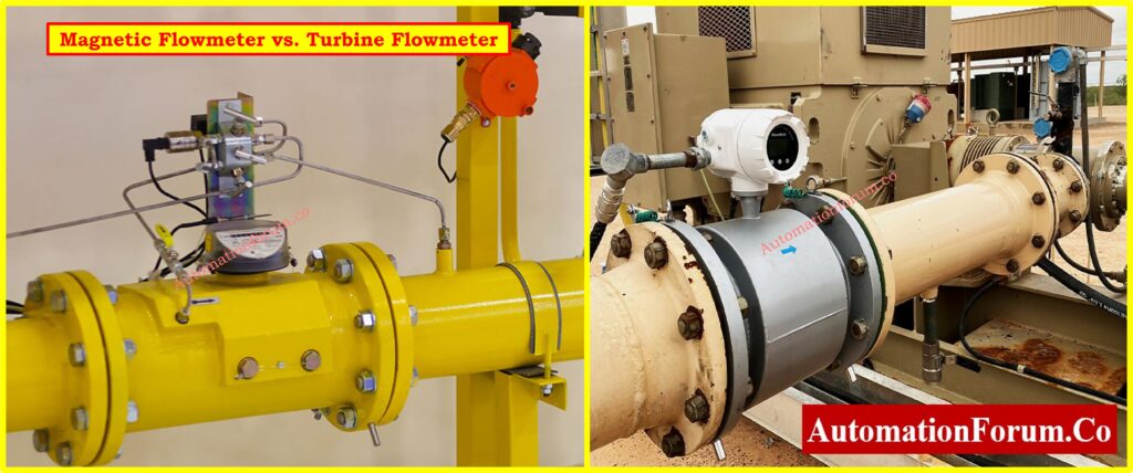

Magnetic Flowmeter vs Turbine Flowmeter – Comparison Table
| S.No. | Feature | Magnetic Flowmeter | Turbine Flowmeter |
| 1 | Principle | Faraday’s Law; induced voltage proportional to flow velocity. | Mechanical; fluid rotates turbine blades, frequency measured. |
| 2 | Fluid Conductivity | Requires conductive liquids (>5 µS/cm). | No conductivity requirement; works with both conductive and non-conductive fluids. |
| 3 | Accuracy | ±0.2–0.5% of reading; stable over time. | ±0.5–1% of reading; affected by viscosity and wear. |
| 4 | Pressure Drop | Minimal due to no obstructions. | Moderate; turbine obstructs fluid path. |
| 5 | Flow Range (Turndown) | High turndown ratio; handles low and high flows accurately. | Limited turndown; poor at very low flow rates. |
| 6 | Maintenance | Low; occasional electrode cleaning. | High; rotor and bearings need replacement over time. |
| 7 | Installation Flexibility | Can be installed in any orientation; full pipe required. | Requires horizontal orientation with straight runs. |
| 8 | Suitable Fluids | Dirty, corrosive, abrasive fluids and slurries. | Clean, non-abrasive liquids or gases. |
| 9 | Energy Consumption | Requires electrical power for magnetic field generation. | Low energy; mainly mechanical. |
| 10 | Cost | Higher initial cost; low lifecycle cost. | Lower initial cost; maintenance adds to long-term cost. |

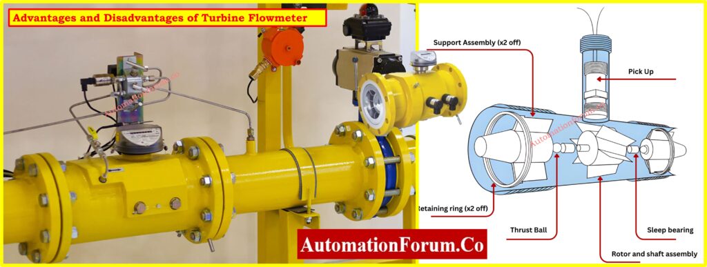

Advantages and Disadvantages of Turbine Flowmeter
Pros:
Works with both conductive and non-conductive fluids
- Works well with hydrocarbons, oils, fuels, cryogenic liquids, and clean gasses
- Because it doesn’t require conductivity, it can be used in a variety of settings.
Lower initial cost
- Not as expensive to buy as magnetic and Coriolis flowmeters
- A good choice for projects with limited funds
Compact and lightweight
- Small installation footprint makes it perfect for systems with limited space.
- Easy to move, set up, and add to skid-mounted equipment.
Cons:
Sensitive to dirt, particles, and fluid viscosity
- Needs fluids that are clean and have a low viscosity to work well
- Debris or solids can hurt turbine blades and make them less accurate.
Requires straight runs and frequent calibration
- Needs enough straight pipe lengths both upstream and downstream to get accurate readings
- Calibration may shift because of mechanical wear, so it needs to be done again and again.
Moving parts can fail in harsh service
- Moving parts can break down in tough conditions.
- Bearings and rotors can wear out quickly, especially when they are used in rough or corrosive conditions.
