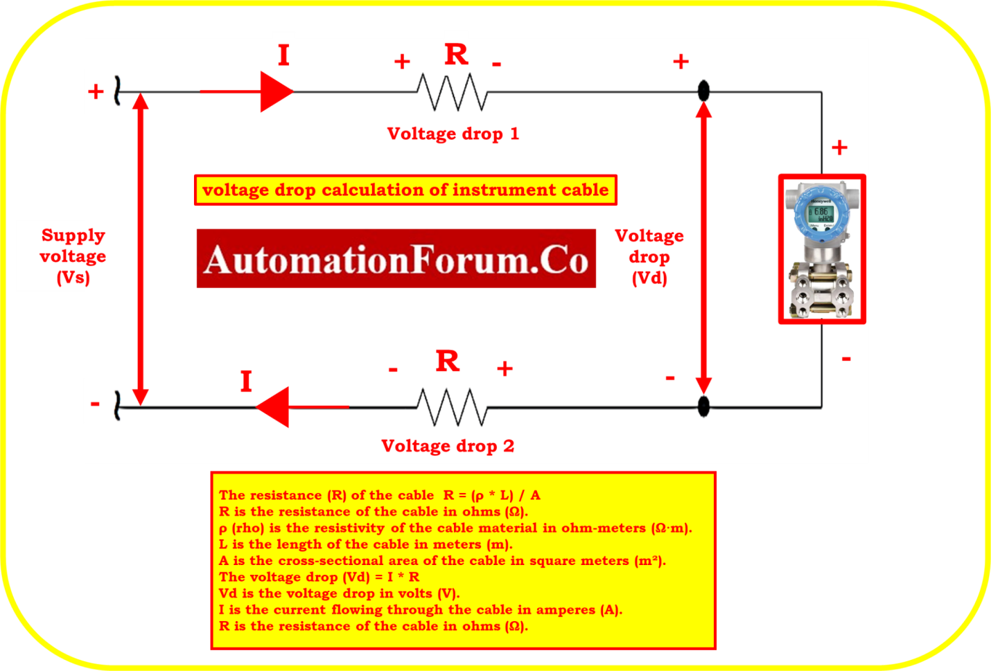

Calculate the resistance of the cable:
The resistance (R) of the cable can be calculated using the formula:
R = (? * L) / A
where:
  • R represents the resistance of the cable in ohms (?).
  • ? (rho) is the resistivity of the cable material in ohm-meters (?·m).
  • L represents the length in metres (m) of the cable.
  • A is the cross-sectional area of the cable in square meters (m²).
Calculate the voltage drop:
The voltage drop (Vd) can be calculated using Ohm’s law:
 Vd = I * R
where:
  • Vd represents the voltage drop in volts (V).
  • I is the current flowing through the cable in amperes (A).
Remember that, depending on the particular application, the voltage drop is typically regarded as acceptable up to a particular percentage of the nominal voltage. The allowable voltage drop limitations for your specific system should be determined by consulting any applicable standards or guidelines.
The cable’s internal resistance(R) = ( ? * L ) / A
Substituting the values:
R = (1.68 x 10-8  ohm-meters * 50 meters) / (1.5 mm²)
Since the cross-sectional area is given in mm², we need to convert it to square meters:
1.5 mm² = 1.5 x 10-6 m²
Substituting the converted values:
R = (1.68 x 10-8 ohm-meters * 50 meters) / (1.5 x 10-6 m²)
R = 0.56 ohms
 To Calculate the instrument cable voltage drop:
Voltage drop (Vd) = I * R
Vd = 2.5 Amperes * 0.56 ohms
Vd = 1.4 volts
Therefore, the voltage drop across the instrument cable in this example is 1.4 volts.
