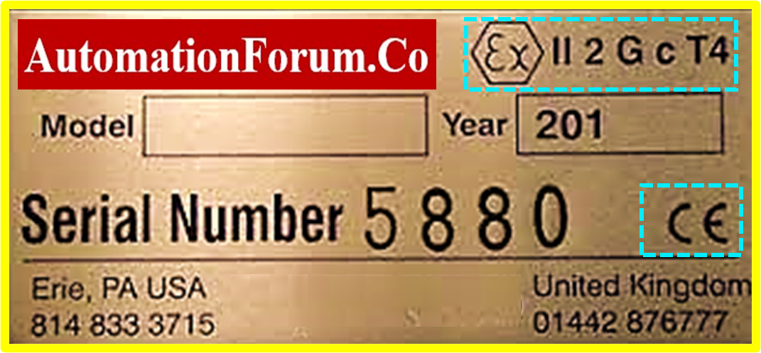

What other marking can be shown?
  • Essential markings include the CE Mark, Ex-marking symbol, ATEX data, manufacturer details, and safety information.
Can you provide an illustration of the CE, EX, and ATEX data marking?
  9876    II  2  G
What does the ATEX data mean?
The ATEX Directive distinguishes two types of equipment.
  • Group 1 equipment is designed for mining applications. M1 and M2 are the two categories. M1 denotes equipment that must continue to work in the presence of a potentially explosive atmosphere. M2 designates equipment that does not work in the presence of a potentially explosive atmosphere.
  • Group 2 is for all other conditions. There are three categories: 1, 2, and 3. Category 1 equipment is designed for usage in Zone O environments. Category 2 equipment is designed for usage in Zone 1 environments. Category 3 equipment is designed for usage in Zone 2 environments.
What are Zones? D and the G?
  • Zoned locations are those where combustible materials may be released into the atmosphere.
  • The subscripts 0, 1, and 2 describe the likelihood of a flammable material being released in explosive concentrations into the atmosphere.
  • The letter G indicates that the item has been tested for potentially explosive atmospheres due to the presence of gas.
  • D indicates that the item has been tested for potentially explosive atmospheres due to dust present.
