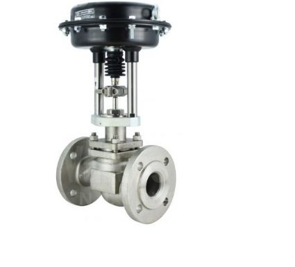

1.What is “quick opening” control valve.
For smaller movement of the stem, there is maximum flow rate.
2..What is “Linear” control valve.
If stem position varies linearly with flow rate, then it is linear.
3.Define Control Valve sizing.
Q=Cv.sqrt(P/Sg)
Q-Flow rate
Cv-Valve coefficient
P-pressure difference across valve.
Sg-Specific gravity of liquid.
4.HOW WILL YOU CHANGE THE ACTION OF A CONTROL VALVE?
IF THE CONTROL VALVE IS WITHOUT BOTTOM FLANGE THE ACTUATOR NEEDS TO BE CHANGED.
IF THE BOTTOM FLANGE IS PROVIDED, DISCONNECT STEM, SEPARATE BODY FROM BONNET.
REMOVE THE BOTTOM FLANGE AND PLUG FROM BODY .
DETACH THE PLUG FROM THE STEM BY REMOVING THE PIN.
FIX THE STEM AT THE OTHER END OF THE PLUG AND FOX THE PIN BACK.
TURN THE BODY UPSIDE DOWN.
CONNECT IT BACK TO THE BONNET AFTER INSERTING THE PLUG AND STEM.
CONNECT BACK THE STEM AND COUPLE IT.
FIX BACK THE BOTTOM FLANGE.
CALIBRATE THE VALVE

9.WHEN DO YOU USE A VALVE POSITIONER?
IF THE DIAPHRAGM ACTUATOR DOES NOT SUPPLY SUFFICIENT FORCE TO POSITION THE VALVE ACCURATELY AND OVERCOME ANY OPPOSITION THAT FLOWING CONDITIONS CREATE A POSITIONER MAY BE REQUIRED
10.WHAT IS “EQUAL PERCENTAGE” IN THE EQUAL PERCENTAGE VALVE?
FOR EQUAL INCREMENT OF STEM TRAVEL AT CONSTANT PRESSURE DROP AN EQUAL PERCENTAGE CHANGE IN EXISTING FLOW OCCURS.

14.WHAT IS FLASHING IN CONTROL VALVE?
WHEN A LIQUIDS ENTERS A VALVE AND THE STATIC PRESSURE AT THE VENA CONTRACTA
LESS THAN THE FLUID VAPOUR PRESSURE AND THE VALVE OUTLET PRESSURE IS ALSO LESS THE
FLUID VAPOUR PRESSURE THE CONDITION CALLED FLASHING EXISTS

18.WHAT IS MEANT BY CAVITATIONS IN CONTROL VALVES?
WHEN A LIQUID ENTERS A VALVE AND THE STATIC PRESSURE AT THE VENA CONTRACTA DROPS TO LESS THAN THE FLUID VAPOR PRESSURE AND THE RECOVERING TO ABOVE FLUID VAPOUR PRESSURE, THIS PRESSURE RECOVERY CAUSES AN IMPLOSION OR COLLAPSE OF THE VAPOUR BUBBLES FORMED AT THE VENA CONTRACTA. THIS CONDITION IS CALLED CAVITATION

21.TYPES OF ACTION / TYPES OF ACTUATOR?
AIR TO CLOSE ( DIRECT ) AND AIR TO OPEN ( REVERSE )
22.TYPES OF BODY DESIGN?
GLOBE VALVE, SINGLE OR DOUBLE SEATED.
ANGLE VALVE,
BUTTERFLY VALVE,
THREE WAY VALVE,
PINCH VALVE,
SAUNDERS VALVE
BALL VALVE.
23.WHAT IS Cv OF A VALVE?
IT IS THE NO. OF U.S GALLONS / MIN. OF H2O WHICH PASS THROUGH A FULLY OPEN VALVE AT A PRESSURE DROP OF 1 PSI AT 60 DEG. F .
24.WHAT TYPE OF BONNETS WOULD YOU USE FOR HIGH TEMPERATURE AND VERY LOW TEMPERATURE?
HIGH TEMPERATURE BONNETS ARE PROVIDED WITH RADIATING FINS.
LOW TEMPERATURE : EXTENDED BONNETS.
