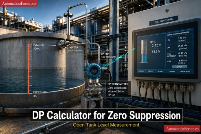

Open tank level measurement with a differential pressure transmitter is one of the most common level applications in process plants. It is used in water tanks, chemical tanks, storage vessels, utility systems, and many commissioning and maintenance jobs where the liquid is open to atmosphere. In this type of application, the transmitter does not always start at true zero. Often the transmitter is mounted below the low point or below the tank reference elevation, so the measured head at empty condition is already above zero. That is where zero suppression becomes important.
A DP calculator for zero suppression helps instrumentation engineers calculate the correct transmitter range before configuration, loop checking, calibration, and startup. It gives the Lower Range Value, the Upper Range Value, and the span based on tank height, specific gravity, and offset below the HP tap. This saves time in the field, reduces range setting mistakes, and makes open tank level measurement calculation much easier to verify during commissioning.
At AutomationForum.co, this kind of calculation is especially useful for engineers who need a quick and reliable differential pressure level transmitter formula for real plant work, not just theory.
Use this DP Calculator for Zero Suppression to quickly calculate LRV, URV, and Span for open tank level measurement applications. Enter tank height, specific gravity, and offset below the HP tap to determine the correct differential pressure transmitter range for calibration, commissioning, and configuration.

Formula used — open tank zero suppression
LRV = SG × h1
URV = SG × (h + h1)
The transmitter range spans from the offset head at empty to offset head plus full tank height at 100% level.
What Is Zero Suppression in Open Tank Level Measurement?
Zero suppression is the adjustment of a differential pressure transmitter range when the transmitter is installed below the HP tap or below the reference point in an open tank level measurement application. In this condition, the transmitter already sees liquid head even when the tank is empty. Because of that, the transmitter does not start from true zero. The lower range value is shifted upward to match the static head created by the installation elevation.

This calculator is built for open tank level measurement using a DP transmitter where the transmitter is installed below the reference tapping point. The logic is simple and practical.
The main inputs are tank height, specific gravity, and offset below the HP tap.
Tank height means the full liquid height from empty to full level. In level applications, it is usually the effective measuring range of the tank.
Specific gravity is the ratio of the liquid density to water density. It tells the transmitter how much pressure is created by the liquid column.
Offset below the HP tap means the vertical distance between the transmitter and the bottom reference point or HP tap. This offset creates head even when the tank is empty.
The calculator then gives:
  • LRV, which is the pressure seen by the transmitter at zero level
  • URV, which is the pressure seen at full level
  • Span, which is the difference between URV and LRV
  • In physical terms, zero suppression means the transmitter zero point is shifted upward because the transmitter already sees positive pressure at empty tank condition. Instead of starting from zero, the transmitter starts from the pressure created by the offset head.

Zero Suppression Formula for Open Tank Level Measurement
The formula used in this calculator is straightforward and very useful in day to day instrumentation level calculation.
For an open tank:
  • LRV = SG × h1
  • URV = SG × (h + h1)
Where:
  • SG is the specific gravity of the liquid
  • h is the tank height
  • h1 is the offset below the HP tap
The span is:
  • Span = URV minus LRV
This simplifies to:
  • Span = SG × h
That means the offset changes the starting point and ending point of the transmitter range, but it does not change the span.
Here is the engineering meaning of the formula.
At empty tank condition, the transmitter still sees the pressure from the liquid column above it if it is mounted below the reference point. That pressure is the LRV. When the tank reaches full level, the transmitter sees the pressure from the full liquid height plus the offset. That pressure is the URV.
So the offset below the HP tap directly pushes both LRV and URV upward by the same amount. This is why zero suppression in level measurement is very common in open tank applications.
This is also why the calculator is useful for LRV and URV calculation for DP transmitter selection and configuration. It helps you define the exact transmitter range before entering values into the field device.
Catch earth fault current risks in intrinsic safety loops: IS Barrier Earth Fault Current Calculator | Intrinsic Safety Loop Design Tool
Zero Suppression Calculation
Let us take a realistic industrial example for open tank level measurement.
Suppose a water based process tank has:
  • Tank height = 3000 mm
  • Specific gravity = 0.85
  • Offset below HP tap = 500 mm
Using the formula:
  • LRV = SG × h1
  • LRV = 0.85 × 500
  • LRV = 425 mmWC
Now calculate the URV:
  • URV = 0.85 × (3000 + 500)
  • URV = 0.85 × 3500
  • URV = 2975 mmWC
Now calculate the span:
  • Span = 2975 minus 425
  • Span = 2550 mmWC
Practical meaning:
  • At empty tank, the transmitter should read 425 mmWC.
  • At full tank, the transmitter should read 2975 mmWC.
  • The transmitter span is 2550 mmWC.
  • This is the correct range for configuration when the transmitter is installed below the HP tap. The result also shows an important point: even when the tank is empty, the transmitter does not read zero because of the offset head. That is the essence of zero suppression.
