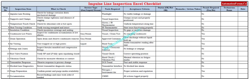

Step 14 Documentation and CMMS Recording
- In the maintenance journal or CMMS, write down the results of the inspection.
- Write down any work done to drain, vent, purge, or fix a valve.
- If possible, include pictures and diagnostic notes.
- For any unusual problems that need fixing, raise work orders.
- Let operations know if anything is affecting the reliability of the measurements.

Impulse Line Inspection Checklist for Routine Rounds
This Excel checklist is meant to help with regular impulse line inspections for DP pressure and flow transmitters. It helps technicians keep track of what they find, make sure they follow SOP rules, and keep measurements reliable.
You may get the full checklist here and utilise it:
