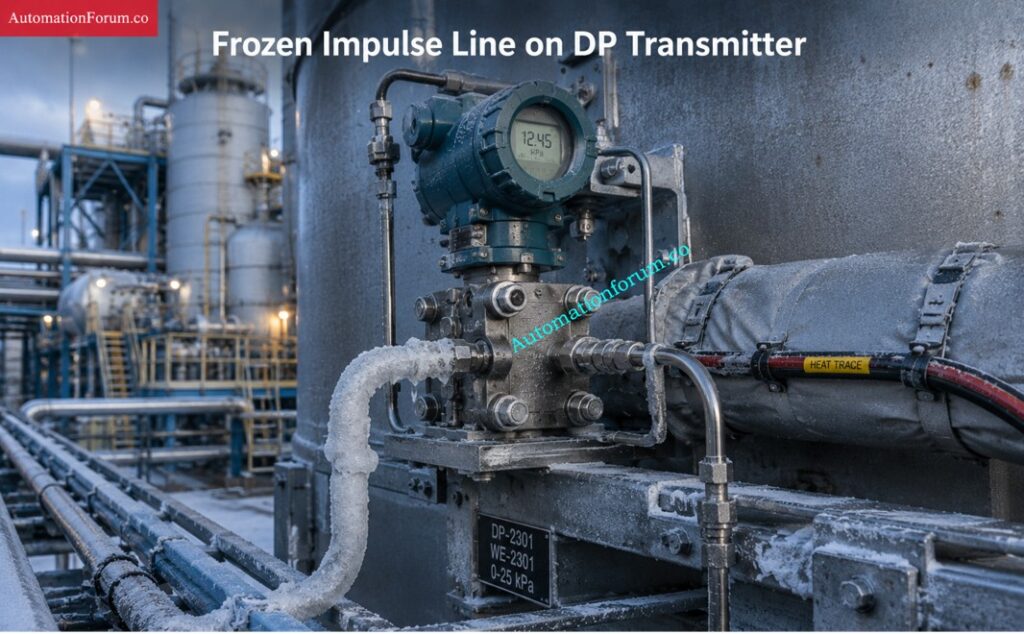

Symptoms of a Frozen Impulse Line
Common signs of impulse line freezing
Frozen impulse lines can create pressure transmitter plugging, false low level trips, frozen condensate, hydrocarbon waxing, blocked pressure sensing, steam condensate freezing, cracked tubing, and instrument shutdowns. In many plants, these problems are first seen during night shifts, cold starts, or troubleshooting after an unexpected alarm.
The real issue is not only the freeze itself. The larger issue is the loss of measurement trust. Once a sensing line becomes unreliable, operators may hesitate, control loops may drift, and shutdowns may follow. This is why impulse line insulation and heat tracing are such important parts of process instrumentation maintenance.

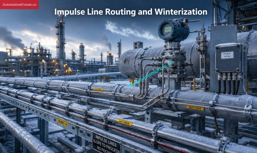

Best Practices for EPC, Maintenance and Commissioning Teams
Proper tubing slope and routing
Impulse lines should be routed with proper slope and minimal dead legs. If the routing is poor, fluids can become trapped and be more likely to freeze. And good routing increases drainage too, and access for maintenance.
Insulation sealing and waterproofing
Insulation must be kept dry to perform effectively. Sealed joints and waterproofing, especially appropriate jacketing, are important. Wet insulation loses effectiveness and can shorten the life of the freeze protection system.

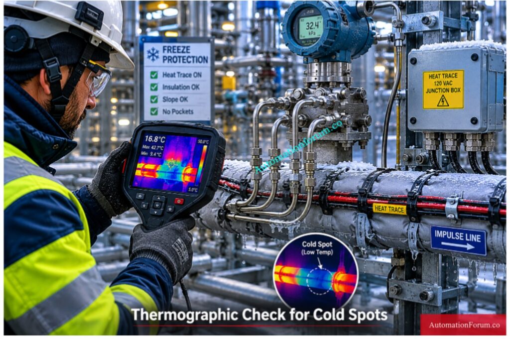

Thermographic inspection for cold spots
Thermography is a useful field tool because it helps identify cold spots, failed sections, or uneven heating. It is one of the easiest ways to verify that the freeze protection system is working properly.
A frozen impulse line often shows up as one or more of these symptoms:
A transmitter reading that suddenly drifts or stays fixed even though the process is changing.
A differential pressure signal that appears too low, too high, or unstable.
A level indication that does not match the actual vessel condition.
Slow response of the transmitter after a chilly night
Alarms or trip circumstances that occur frequently but clear up as the line thaws.
These symptoms usually point to a freeze protection issue rather than a bad transmitter. In many cases, the instrument is only reporting what the blocked line allows it to see.

Impulse tubing is normally installed with a proper slope to prevent air pockets, liquid traps, and condensate buildup.
The exact slope depends on the service, but it should always allow drainage and stable measurement.

What happens if a DP impulse line freezes?
The reading can be inaccurate, delayed, obstructed or unstable. This may compromise control and safety operation.
