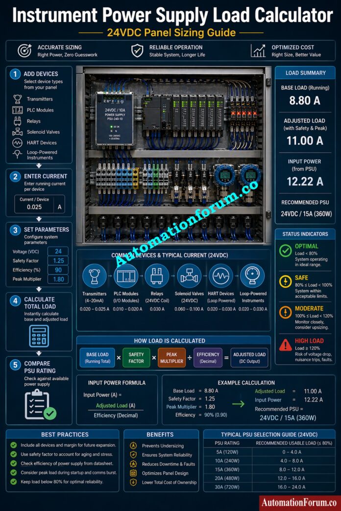

The Instrument Power Supply Load Calculator is essential for accurate 24VDC power supply sizing in industrial automation systems. In plant environments, even a small error in instrument load calculation can create unstable loop voltage, nuisance trips, communication loss, or complete shutdown of a control panel. For instrumentation engineers, control engineers, EPC teams, and plant maintenance professionals, power supply sizing is not a routine task. It is a reliability decision that affects uptime, safety, and operating cost.
When a power supply is undersized, the failure may not appear immediately. A transmitter may reset during peak demand, a relay may chatter, a solenoid valve may fail to actuate, or a PLC rack may drop communication under load. These issues often begin as intermittent faults and later become production losses. That is why the Instrument Power Supply Load Calculator should be used at the design stage, before panel fabrication and before field commissioning.
This calculator helps engineers estimate total current, total power, adjusted operating load, and safe power supply rating with practical engineering margins. It supports reliable panel design power calculation, field instrument current consumption review, and industrial automation power calculation for both new projects and retrofit systems.
⚡ Instrument Power Supply Load Calculator

How Power Supply Load Calculation Works -  - Instrument Power Supply Load Calculator:
The core idea behind power supply sizing is simple, but the engineering detail matters.
Total current is the sum of the current drawn by all connected devices under normal operating conditions. In an instrumentation panel, this may include multiple transmitters, a PLC rack, I O modules, relays, indicators, communication devices, and solenoids. The calculator combines these values to produce base load current.
IS Barrier Earth Fault Current Calculator: IS Barrier Earth Fault Current Calculator | Intrinsic Safety Loop Design Tool
Total power is calculated by multiplying current by voltage. In a 24VDC system, even moderate current can create a significant power demand. A control panel design should always convert current based load into total watts so the engineer can compare it with the power supply rating and thermal limits.
A safety factor is not waste. It is engineering margin. It protects the system against device tolerance variation, future additions, ambient temperature changes, and short term load spikes. For most power supply sizing for transmitters and PLC power supply calculation tasks, a realistic safety factor improves reliability without oversizing the panel unnecessarily.

Step-by-Step Guide to Using the Power Supply Load Calculator -  - Instrument Power Supply Load Calculator:
First, add all the devices that will get power from the same DC supply. Include any other 24VDC loads, such as transmitters, PLC modules, relays, and solenoids.
Second, enter the current value for each device. Use the real operating current wherever possible. For engineering estimate work, use vendor data sheets or proven project standards.
Third, make that the nominal voltage, safety factor, efficiency, and peak multiplier are all configured to meet the design requirements for the panel.
Fourth, click “Calculate” and go over the results. The tool will add up the base load, add an engineering margin, guess the ultimate power supply rating, and let you know if the chosen supply is safe.
Fifth, if necessary, compare the result to the actual catalog rating and choose the next size that fits. In panel design, it is always better to choose a supply with proper margin than to run a unit at the edge of its limit.

Consider a 24VDC instrumentation panel serving one process skid.
The panel includes 10 transmitters at 25 mA each, 5 solenoid valves at 250 mA each during energization, and 1 PLC rack with I O modules drawing 800 mA. The base current becomes 10 times 25 mA plus 5 times 250 mA plus 800 mA, which gives a practical total load for the calculator.
Now add a safety factor of 25 percent because the skid may later include more field devices. Use 85 percent efficiency because no supply is perfect, and apply a peak multiplier of 1.2 because multiple outputs may energize together.
The engineering decision here is not just to pick a supply that barely matches the current. The correct action is to choose a PSU size that keeps the system stable during startup, high ambient temperature, and future loop additions. In many plant projects, this means selecting the next higher standard rating instead of the absolute minimum.
This kind of industrial automation power calculation prevents nuisance faults, supports better commissioning, and reduces maintenance callouts.
