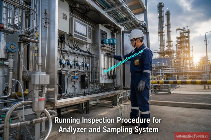

Running Inspection Procedure for Analyzer and Sampling System in Process Industries
Table of Contents
In today’s process industries, online analyzer systems are quite important. Refineries, petrochemical plants, chemical industries, power plants, pharmaceutical facilities, and oil and gas installations all rely on analyzers to keep an eye on process conditions, product quality, environmental compliance, and safety at work.
A process analyzer can only give accurate readings if both the analyzer and the sampling mechanism are working properly. Blocked filters, low sample flow, condensation inside tubing, pressure instability, leaking fittings, contaminated sample lines, and inappropriate temperature conditioning are all problems that might cause the analyzer to give false readings and data that aren’t stable. If the analyzer data is wrong, it could lead to bad decisions about process control, lost production, goods that don’t meet specifications, safety issues, and unplanned shutdowns.
Regular running inspections help find these faults before they get worse. Checking the sample flow, filters, regulators, heat tracing, moisture removal systems, tubing connections, analyzer alarms, and calibration status properly makes sure that process monitoring is accurate and that analyzers are more reliable.
The running inspection approach below is a useful guide for instrumentation engineers, analyzer technicians, maintenance workers, and commissioning engineers that work in industrial process plants.
