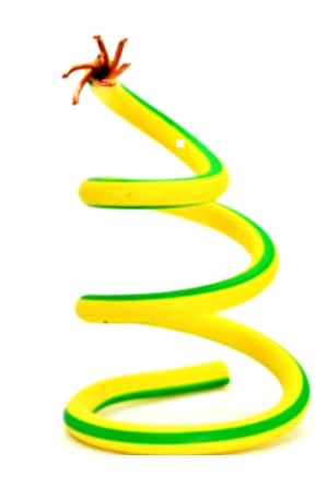

What does PE mean on a wiring diagram?
PE means protective earth conductors, and PE conductors are required to be:
- insulated, with stripes of yellow and green coloration
- Defendable against both physical and chemical deterioration
It should be noted that construction for busways makes this possible (busbar trunking systems)
Conductors of PE must:
It is essential that no ways of interrupting the circuit’s continuity be included (such as a switch, removable links, etc.)
As shown in the below figures, connect each exposed conductor separately to the main PE conductor, not all at once.
Give each earthing bar on a distribution board its own terminal.
