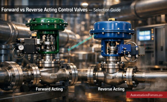

When to Choose Forward and Reverse Acting Control Valves for Design Engineer
Control valves are the backbone of any process control system. In industries such as oil and gas, petrochemical, power generation, and manufacturing, they act as the final control element that directly influences process variables like flow, pressure, temperature, and level.
When designing a plant in real life, engineers generally spend a lot of time choosing transmitters, setting up controllers, and adjusting PID loops. However, one of the most critical and frequently misunderstood decisions is selecting the correct control valve action.
From field experience, incorrect selection between a forward acting control valve and a reverse acting control valve can result in:
  • Unstable control loops
  • Opposite process response
  • Poor controllability during disturbances
  • Dangerous plant conditions during failure scenarios
In EPC projects, it is common to see loop performance issues traced back not to controller tuning, but to incorrect valve action or fail safe configuration. A poorly selected valve can make even a well tuned control loop behave unpredictably.
Understanding valve action is therefore not just a theoretical requirement. It is a practical necessity for safe and stable plant operation.
Calculate Control Valve Stroke Now: Control Valve Stroke Length Calculator
Control valve action tells you how the valve reacts when the controller output signal changes.
A forward acting control valve:
  • More output from the controller means the valve will open more.
  • Signal up results in flow increase
In a reverse acting control valve:
  • Increase in controller output leads to decrease in valve opening
  • Signal up results in flow reduction
This represents an inverse relationship between signal and valve movement.
In real systems, this relationship determines how the process reacts:
  • Direct relationship means controller output reinforces process increase
  • Reverse relationship means controller output reduces process effect
From an instrumentation design engineering perspective, this relationship must align with process requirements. Otherwise, the system may respond in the wrong direction.
Master Forward Versus Reverse Valve Action: Working of Direct Acting and Reverse Acting Control Valve Loop
Air to Open vs Air to Close Valve Explained for Engineers
A key concept closely linked with valve action is actuator behavior.
  • Increasing air pressure opens the valve
  • Loss of air causes the valve to close
  • Known as fail close valve
  • Increasing air pressure closes the valve
  • Loss of air causes the valve to open
  • Known as fail open valve
Bench Set Actuators for Fail Safe Performance: Why is Control Valve Actuator Bench Set Important ?
The actuator contains a spring mechanism that defines the fail position during air loss.
In practical plant design:
  • Air to open is typically used when stopping flow is safer
  • Air to close is used when maintaining flow is safer
Many engineers confuse:
  • Valve action
  • Controller action
  • Positioner configuration
These are independent but interconnected elements. The final valve behavior depends on how all three are configured together.
Compare Control Valve Actuators Fast: Basic Types of Control Valve Actuators
A fundamental concept in process control loop design is process gain.
  • Valve opening increases process variable
  • Example: flow control loop
  • Valve opening decreases process variable
  • Example: cooling water reduces temperature
The controller must act opposite to the process behavior to maintain stability.
  • Positive gain process → reverse acting controller
  • Negative gain process → direct acting controller
This principle ensures that the controller output drives the system toward the setpoint rather than away from it.
From field experience, ignoring process gain is one of the most common reasons for loop instability.
Choose Valve Body Material Like a Pro: Control Valve Body Material Selection Guide for EPC Design Instrumentation Engineers
A forward acting control valve is selected when an increase in the control signal must result in an increase in flow or process effect. In simple terms, the valve movement follows the direction of the signal, meaning signal up leads to valve opening up. This direct relationship between controller output and valve position is fundamental in many process applications where increasing the manipulated variable helps correct the process deviation.
From an instrumentation design engineering perspective, forward acting valves are preferred in systems where the process requires immediate reinforcement of flow or removal of energy as the process variable increases.
Cooling System Control Logic Temperature Increase Flow Increase
In cooling applications, the process variable is typically temperature, and the objective is to remove heat efficiently.
  • Increase in temperature requires more cooling
  • Controller detects high temperature and increases output
  • Valve must open to allow more cooling medium
This makes forward acting control valves highly suitable for cooling water circuits, heat exchangers, and jacket cooling systems.
  • Reactor temperature rises
  • Controller output increases
  • Cooling water valve opens further
This ensures that heat removal increases proportionally with temperature rise.
From field experience, incorrect valve action in cooling loops often results in dangerous scenarios. If the valve closes when temperature rises, the system will move toward thermal runaway instead of stabilizing.
In pressure control situations where venting or relief is needed:
  • More discharge or venting is needed when the pressure goes up.
  • As pressure goes up, the controller output goes up.
  • To alleviate too much pressure, the valve must open.
Forward Acting Valve in Flare and Vent Gas Systems
Forward-acting valves make sure that pressure is lowered promptly and effectively.
Typical applications include:
  • Flare systems
  • Vent gas systems
  • Compressor anti surge lines
In standard flow control applications:
  • Increase in controller output should increase flow
  • Valve opening must increase proportionally
This is the most straightforward application of forward acting control valves and is widely used in:
  • Feed flow control
  • Transfer lines
  • Utility distribution systems
Since the process gain is positive in these cases, a direct relationship between signal and flow is required for stable control.
One of the most critical aspects of selecting a forward acting control valve is the associated fail safe behavior.
These systems often need a fail-open valve setup, which means:
  • The valve opens when the air supply is cut off.
  • Systems for cooling water
  • Lubrication systems for compressors
  • Lines for emergency venting and lowering pressure
The reason is straightforward:
If the air supply fails, the safest thing to do is to keep or increase the flow, not stop it.
For example:
  • Equipment can be damaged if cooling water is lost.
  • Mechanical breakdown can happen if lubrication is lost.
Fail open makes sure that protection stays in place even if the instrument air fails.
In EPC design and commissioning, forward-acting valves follow a simple control logic:
  • The temperature goes up, which makes the controller output go up, which opens the valve.
  • When pressure goes up, the controller output goes up, and the valve opens.
This is in line with what operators expect and makes it easier to fix problems.
From what I’ve seen in the field:
  • Loop behavior is easy for operators to grasp.
  • Engineers who work on maintenance can find problems faster
  • Loop tuning becomes easier to forecast
This clarity makes it less likely that people will make mistakes and makes the plant more reliable amid interruptions.
Stop Control Valve Hunting Today: Control Valve Hunting Due to PID Controller: Causes, Effects, Root Analysis and Complete Troubleshooting Guide for Industrial Process Control Systems
When a control signal has to go up, a reverse acting control valve is used to make the flow or process effect go down. In this example, the valve moves in the opposite direction of the signal, thus when the signal goes up, the valve closes.
Most of the time, these valves are utilized in systems where adding energy or material is part of the process, and lowering the input is needed to raise the process variable.
In heating applications, the goal of the process is to keep the temperature stable by managing the amount of energy that goes in.
  • If the temperature goes up, the heating needs to go down.
  • The output of the controller goes up.
  • To lower the amount of heat coming in, the valve must close.
Reverse acting control valves are ideal for such systems.
  • Heat exchangers
  • Furnaces
  • Thermal oil systems
  • Temperature exceeds setpoint
  • Steam or fuel valve closes
This reduces heat input and stabilizes the process.
Steam Flow Control Based on Temperature Feedback
Steam is one of the most common heating media in process industries.
  • Steam adds energy to the process
  • High temperature requires reduction in steam flow
  • Valve must close as signal increases
Reverse acting valves are therefore widely used in:
  • Steam flow control
  • Temperature control loops
  • Reboilers and distillation columns
From engineering experience, steam valves are almost always configured as air to open valve with fail close behavior to ensure safety.
Reverse Acting Control Valve in Level Control Systems
