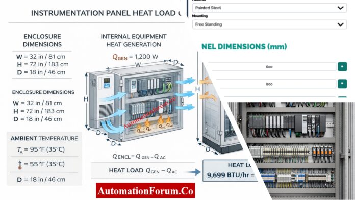

Instrumentation Panel Heat Load Calculator - Complete Engineering Guide for Panel Cooling Design
Instrumentation and control panels are the most important parts of plant automation in today’s process industries. These panels have delicate electronic parts such PLCs, DCS controllers, power supply, relays, safety systems, analyzers, communication modules, and devices for industrial networking. While they are running, all of these parts constantly create heat.
If the heat produced isn’t correctly measured and eliminated, the temperatures inside the panels can go above safe levels. This can cause frequent failures, unexpected shutdowns, communication mistakes, and long-term dependability problems. This is when an Instrumentation Panel Heat Load Calculator becomes an important tool for engineers.
AutomationForum’s Instrumentation Panel Heat Load Calculator is made to help engineers figure out the overall heat load inside an enclosure and how much cooling is needed. It follows IEC and IEEE requirements and supports best practices in engineering, so it may be used for professional design, EPC documentation, and real plant applications.
PLC Control Panel Inspection Checklist – Field-Ready Guide: Running Inspection Checklist of PLC Components in Control Panels
Instrumentation Panel Heat Load Calculator | IEC-Compliant Panel AC Sizing Tool
AUTOMATIONFORUM.CO
✔ IEC 61439 Aligned    ✔ Industry-Proven U-Values    ✔ EPC / OEM Ready
ENCLOSURE DETAILS
PANEL DIMENSIONS (mm)
THERMAL & SITE DATA
Calculation ID: AF-HL- | Generated on
This calculator provides an engineering estimate. Final equipment selection shall consider solar load, enclosure sealing, air leakage, and manufacturer recommendations.

How Panel Heat Load Calculation Works - Engineering Logic Explained
The calculator follows a structured engineering methodology.
The internal heat load is the total of all the power losses in the equipment:
Internal Heat Load (W) = Σ Equipment Power Dissipation
To find the entire external surface area, use the formula:
Surface Area = 2 × (WH + WD + HD)
Where:
  • W = Width (m)
  • H = Height (m)
  • D = Depth (m)
ΔT = Outside Temperature – Desired Internal Temperature
For heat transmission, only temperature changes that are positive are taken into account.
To figure out how much heat is transmitted through the walls of an enclosure, use this formula:
External Heat Load = Surface Area × ΔT × U-value
The U-value changes according on the material of the enclosure and how it is mounted.
To take into account the fact that air is less dense at higher altitudes:
Altitude Factor ≈ 1 + (Altitude / 1000 × 0.03)
To make sure the system works reliably, the calculated heat load is multiplied by the safety factor that was chosen.
Total Heat Load = (Internal + External Heat Load) × Altitude Factor × Safety Factor
We turn the resulting heat load into standard engineering units:
  • 1 W = 3.412 BTU/hr
  • 1 TR = 3.517 kW

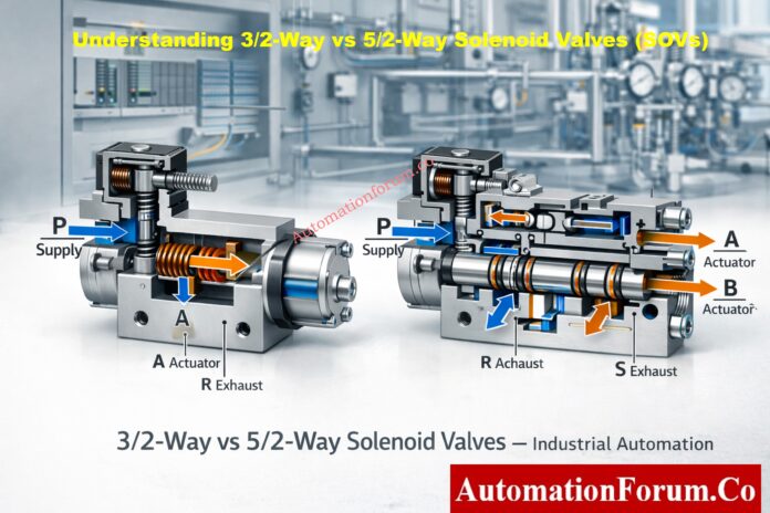

Understanding 3/2-Way vs 5/2-Way Solenoid Valves (SOVs)
Solenoid valves (SOVs) are frequently tiny devices with enormous significance in industrial automation. They serve as the last stage of execution between a physical process movement and an electrical control signal. Incorrect fail action, dangerous plant conditions, annoyance trips, actuator hunting, or complete loss of control can result from a poorly chosen solenoid valve.
Plant applications are dominated by 3/2-way and 5/2-way solenoid valves among all solenoid valve configurations. Every instrumentation and control engineer must have a basic understanding of their functional behavior, air-flow logic, fail response, and system integration.
With an emphasis on actual plant conditions, safety philosophy, and engineering decision-making, this article provides the most practical explanation of 3/2-way vs. 5/2-way solenoid valves.
An electrical signal is transformed into pneumatic motion by a solenoid valve, an electro-pneumatic control device. Compressed air is redirected when the solenoid coil is activated because it creates a magnetic field that moves a plunger or spool inside the valve body.
Solenoid valves are essential because they:
  • serve as the interface between pneumatic actuators and PLC/DCS logic, converting digital ON/OFF outputs into mechanical movement that opens or closes valves.
