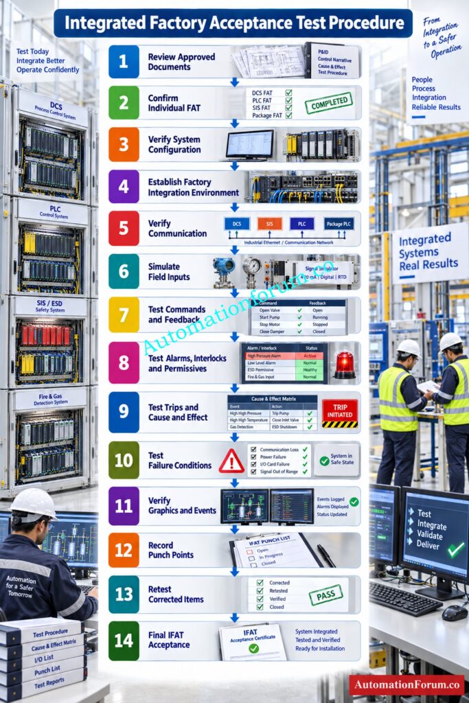

What is the Typical IFAT Procedure?
A practical Integrated Factory Acceptance Test can be executed through the following sequence.
Step 1: Review Approved Engineering Documents
Review the Functional Design Specification, System Design Specification, Cause and Effect Matrix, I O list, control narratives, network architecture, communication documents and approved test cases.
Step 2: Confirm Individual FAT Completion
The participating DCS, PLC, SIS and package systems should have completed their required individual FAT activities before integration testing begins.
Step 3: Verify DCS PLC SIS and Package Configuration
Check controller setup, databases, tag mapping, communication settings, visuals and application logic to approved project configuration.
Calculate Intrinsic Safety Parameters Before Hazardous Area Installation: Intrinsic Safety Entity Parameter Calculator for Reliable Hazardous Area Loop Design
Step 4: Establish the Factory Integration Environment
Connect the necessary systems in a controlled production setting. Suitable simulation tools and test interfaces can be employed if actual field equipment is not accessible.
Step 5: Verify Communication Interfaces
Verify the communication lines and correct interchange of all relevant data points. Check addresses, data kinds, scaling, units and update behavior.
Step 6: Simulate Field Inputs and Equipment Status
Produce simulated process values, equipment status indications, Alarms and abnormal circumstances.
Step 7: Test Commands and Status Feedback
Issue operator commands and check that the receiving system processes them successfully and delivers the anticipated status.
Step 8: Test Alarms Interlocks and Permissives
Apply the needed conditions and check the desired control and shutdown response.
Step 9: Test Trips and Cause and Effect
Simulate representative process and safety incidents and validate full reaction across interconnected systems.
Understand Process And Functional Safety Before Critical Decisions: ESD vs PSD: Difference Between Emergency Shutdown System and Process Shutdown System
Step 10: Test Communication and System Failure Conditions
Verify defined communication failures, duplicated pathways, and other applicable abnormal circumstances.
Step 11: Verify Operator Graphics and Events
Check operator indications, alarms, event messages, time-stamps and historical data as appropriate.
Step 12: Record IFAT Punch Points
Step 13: Complete Final IFAT Acceptance
After successful retesting, obtain the required approvals and document the final IFAT status before shipment or site deployment.

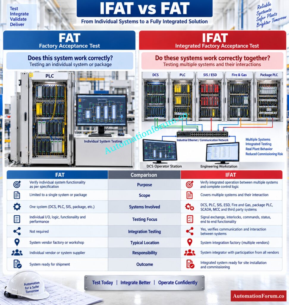

IFAT vs FAT: What is the Difference?
| Area | FAT | IFAT |
| Purpose | Verify an individual system or equipment package | Verify interaction between multiple systems |
| Scope | Usually one system or package | Multiple connected systems |
| Systems involved | DCS, PLC, package or other individual system | DCS, PLC, SIS, ESD, FGS and third party systems |
| Testing focus | Functional and technical requirements | Integration and end to end functionality |
| Typical location | Vendor or system integration facility | Factory integration environment |
| Integration testing | Limited or system specific | Major testing objective |
| Responsibility | Mainly system or package vendor | Multiple vendors, system integrator and project team |
| Outcome | Individual system acceptance | Confidence in integrated system behavior |
An individual FAT answers the question, “Does this system work correctly?”
IFAT goes further and asks, “Do these systems work correctly together?”

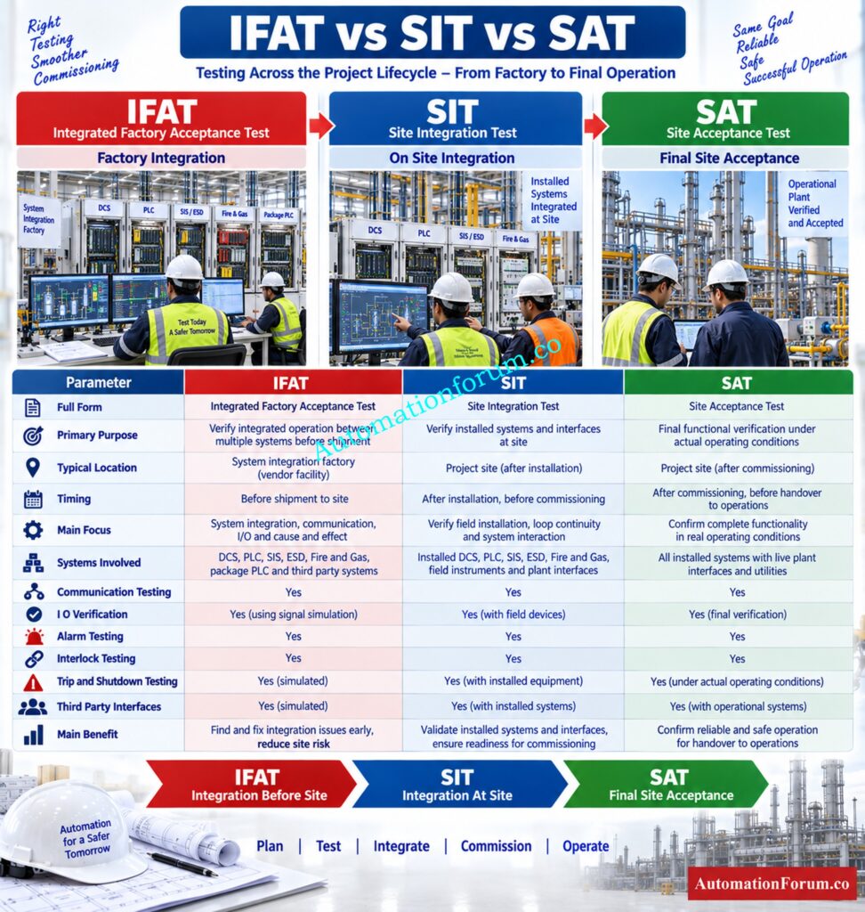

IFAT vs SIT vs SAT: What is the Difference?
| Parameter | IFAT | SIT | SAT |
| Full Form | Integrated Factory Acceptance Test | Site Integration Test | Site Acceptance Test |
| Primary Purpose | Verify integration and interaction between multiple systems before site installation | Verify integration of installed systems at site | Verify that the installed system meets project functional and acceptance requirements |
| Typical Location | Factory or system integration facility | Project site | Project site |
| Timing | Before shipment and site installation | After system installation and during site commissioning | After installation and required commissioning activities |
| Main Focus | System integration and end to end functionality | Site integration and system interaction | Final acceptance of the installed system |
| Systems Involved | DCS, PLC, SIS, ESD, FGS and third party systems | Installed DCS, PLC, SIS, ESD, FGS and other plant systems | Complete installed control and automation system |
| Communication Testing | Verified before site installation | Verified using installed site networks and interfaces | Verified as part of final system acceptance |
| I O Verification | Mainly through simulated inputs and system interfaces | Verified with installed field interfaces where applicable | Verified under actual site conditions |
| Alarm Testing | Simulated and verified through integrated systems | Verified using installed systems | Verified as part of site acceptance |
| Interlock Testing | Verified using simulation and integrated system logic | Verified using installed equipment and actual interfaces where applicable | Verified against approved functional requirements |
| Trip and Shutdown Testing | Integrated trip logic can be tested using simulated conditions | Site installed trip functions can be verified | Final acceptance of required shutdown functionality |
| Third Party Interfaces | Tested before equipment reaches site | Tested with actual installed interfaces | Confirmed as part of final site acceptance |
| Main Benefit | Finds integration problems before site commissioning | Confirms correct integration after installation | Confirms that the installed system satisfies project requirements |
| Typical Outcome | Integrated system accepted for shipment or site deployment | Site integration verified | System accepted according to project acceptance criteria |
Important: The exact meaning and scope of IFAT, SIT and SAT can vary between projects and organizations. Some projects may use SIT for integration activities that are similar to IFAT. Therefore, instrumentation and control engineers should always follow the project specific testing philosophy, contractual requirements and approved test procedure.
