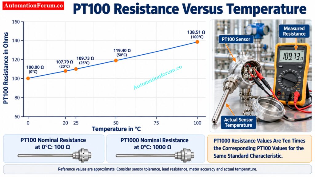

PT100 Resistance Versus Temperature Table
For a standard IEC 60751 PT100, the approximate reference values are:
TemperaturePT100 Resistance
0°C100.00 ohms
20°C107.79 ohms
25°C109.73 ohms
50°C119.40 ohms
100°C138.51 ohms
For a PT1000 with the same standard characteristic, the corresponding nominal resistance values are ten times those of a PT100.

Suppose a disconnected PT100 sensor has stabilized at approximately 25°C and the multimeter measures 109.73 ohms.
This measurement is in line with the nominal PT100 characteristic at 25°C . However the assessment should take into account sensor tolerance, meter accuracy, actual sensor temperature and lead resistance.
In a two wire arrangement, the measured resistance includes both connecting leads. Three wire and four wire arrangements help reduce the influence of lead resistance when used with compatible measurement circuits.
Do not conclude that a sensor is fully calibrated simply because its resistance matches one reference value.
