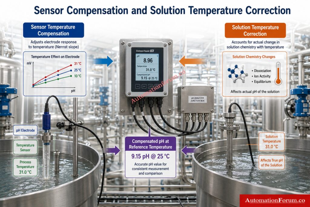

What Is pH Sensor Temperature Compensation?
How pH Sensor Temperature Compensation Works
pH sensor temperature compensation is the process of accounting for the change in electrode response caused by temperature.
A glass pH electrode develops an electrical potential proportional to the hydrogen ion activity. The electrode response is dependent on temperature. Therefore, the millivolt response corresponding to one pH unit is not constant at every temperature.
The theoretical Nernst slope at 25 °C is approximately 59.16 mV per pH. As absolute temperature increases, the theoretical slope also increases.
This is why a pH transmitter with automatic temperature compensation normally receives temperature information from a temperature element installed with the pH sensor.
However, sensor temperature compensation and solution temperature compensation are not the same thing.
Sensor Temperature Compensation vs Solution Temperature Compensation
Sensor compensation corrects the temperature dependence of the electrode response.
Solution compensation considers the actual change in process liquid pH caused by temperature.
The calculator treats these effects separately, which is important when evaluating pH measurement temperature compensation in a real process.

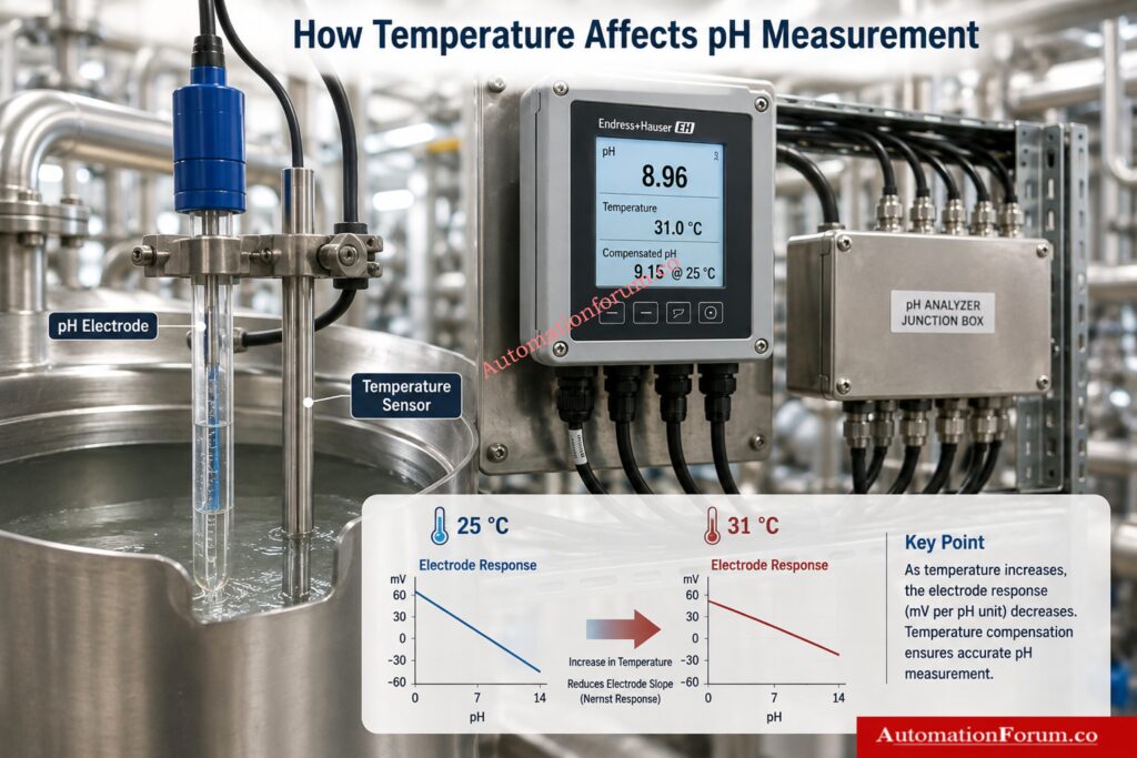

Why Does Temperature Affect pH Measurement?
A pH electrode generates an electrical potential according to the Nernst relationship. In practical terms, the electrode produces a different millivolt response for the same pH as its temperature changes.
At 25 °C, the theoretical Nernst slope is approximately 59.16 mV per pH.
For an instrumentation engineer, this explains why a pH transmitter needs reliable temperature information when automatic temperature compensation is required.
The temperature element is particularly important because the transmitter must know the actual sensor temperature rather than relying on an assumed process temperature.
A wrong temperature input can therefore result in an incorrect compensated pH value.

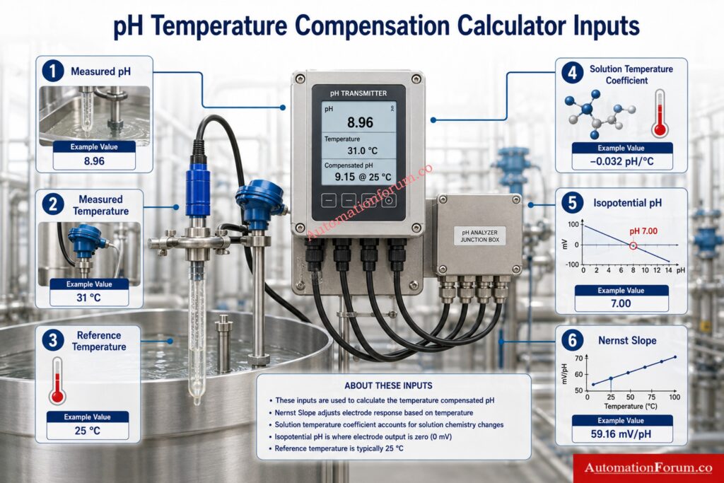

Inputs Required for the pH Temperature Compensation Calculator
| Parameter | What it means | Engineering consideration |
| Measured pH | pH indicated at the actual measurement temperature | Use the pH value associated with the measured temperature |
| Measured Temperature | Actual temperature of the pH measurement | Use the temperature measured by the sensor assembly where possible |
| Reference Temperature | Temperature to which the pH result is compared | 25 °C is a common reference, but another value can be selected |
| Solution Temperature Coefficient | Change in actual solution pH per °C | Use reliable process or laboratory information |
| Isopotential Point | pH at which sensor output is theoretically independent of temperature | Use the sensor manufacturer’s appropriate value when available |
| Nernst Slope at 25 °C | Base electrode sensitivity used by the calculation | The theoretical value is approximately 59.16 mV per pH |
| Actual Measured Nernst Slope | Electrode slope obtained from calibration | Use only when reliable two point calibration information is available |
The calculator allows either the theoretical slope or an actual measured slope to be selected.

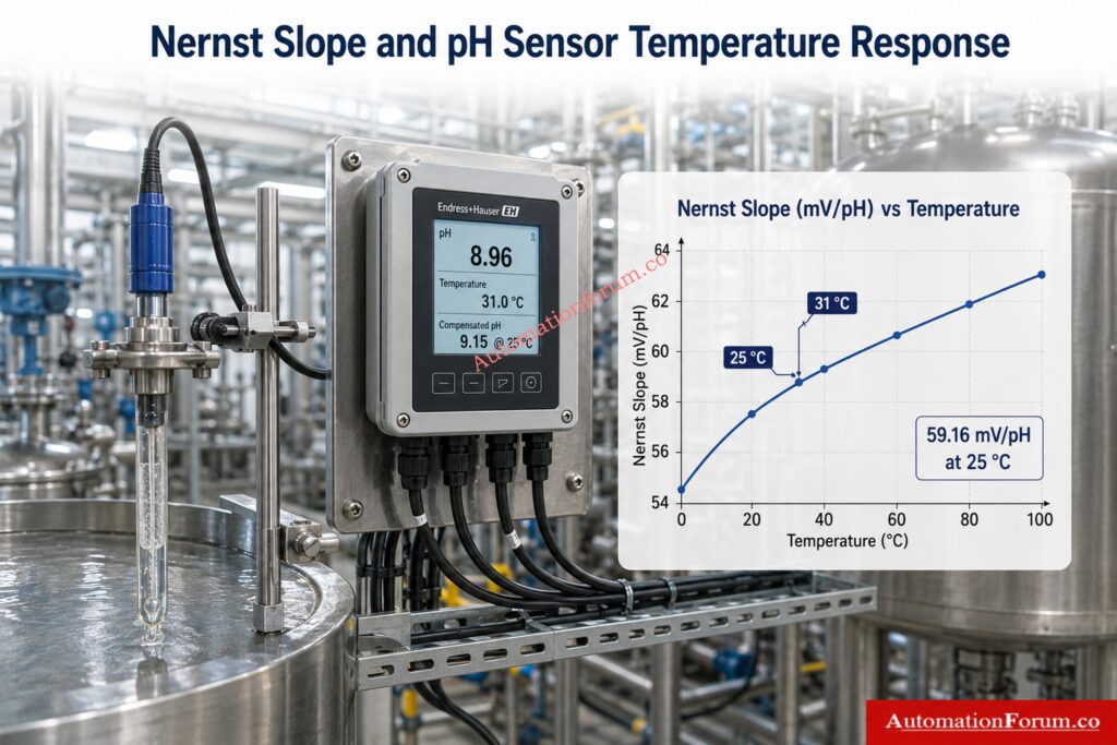

Understanding the Nernst Slope in pH Sensors
The Nernst slope represents the electrical sensitivity of the pH electrode.
At 25 °C, the theoretical value used by the calculator is 59.16 mV per pH. The actual slope of an electrode can differ from the theoretical value because of sensor condition, calibration condition and individual sensor characteristics.
The calculator provides two choices.
Theoretical slope uses the entered Nernst slope at 25 °C.
Actual measured slope uses a slope obtained from a two point calibration.
An actual measured slope can be useful when reliable calibration data represents the condition of the electrode. However, it should not automatically be considered better than the theoretical value. Poor calibration data, unsuitable buffers or an unstable electrode can produce an unreliable slope.
The important point is to use a slope value that represents the sensor and calibration conditions being evaluated.

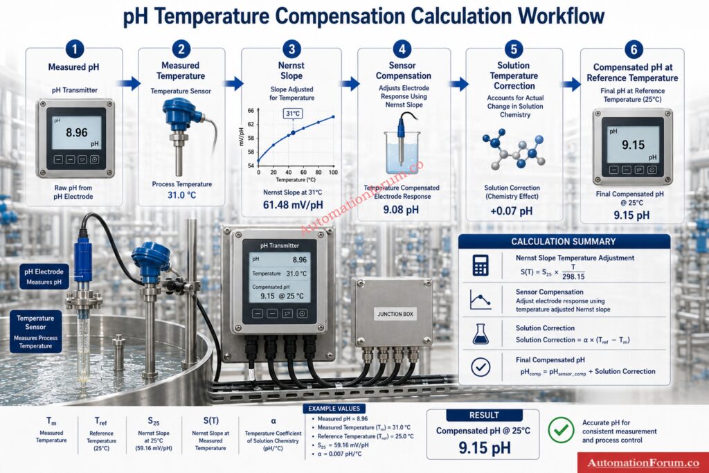

How the Calculator Performs the pH Temperature Compensation
The calculator uses absolute temperature when calculating the Nernst slope.
Nernst slope at measurement temperature
S(Tm) = S25 × Tm / 298.15
Nernst slope at reference temperature
S(Tref) = S25 × Tref / 298.15
Temperatures used in these equations are absolute temperatures in Kelvin.
Sensor Compensated pH Calculation
pHref,sensor = pHiso + [S(Tm) / S(Tref)] × [pHm − pHiso]
This calculation adjusts the measured pH according to the change in electrode sensitivity between the measured temperature and reference temperature.
Solution temperature correction
Correction = α × (Tref − Tm)
Here, α represents the solution temperature coefficient.
Final Compensated pH Calculation
pHref = pHref,sensor + Correction
Understand Why Cell Constant Controls Measurement Accuracy: Understanding Cell Constant in Conductivity Analyzers and its Significance
pH Temperature Compensation Calculation Example
Consider the default values provided in the calculator.
Measured pH is 8.96.
Measured temperature is 31 °C.
Reference temperature is 25 °C.
Solution temperature coefficient is −0.032 pH per °C.
Isopotential pH is 7.00.
Nernst slope at 25 °C is 59.16 mV per pH.
The calculator first determines the Nernst slope at 31 °C and at 25 °C. It then uses the ratio of these slopes to calculate the sensor compensated pH around the isopotential point.
The solution correction is calculated separately using the temperature difference between 25 °C and 31 °C.
For these values, the solution correction is:
−0.032 × (25 − 31) = +0.192 pH
This demonstrates why the solution coefficient can have a substantial influence on the final result. The process solution effect should therefore not be confused with the sensor response correction.
The calculator combines both contributions to produce the compensated pH at 25 °C.

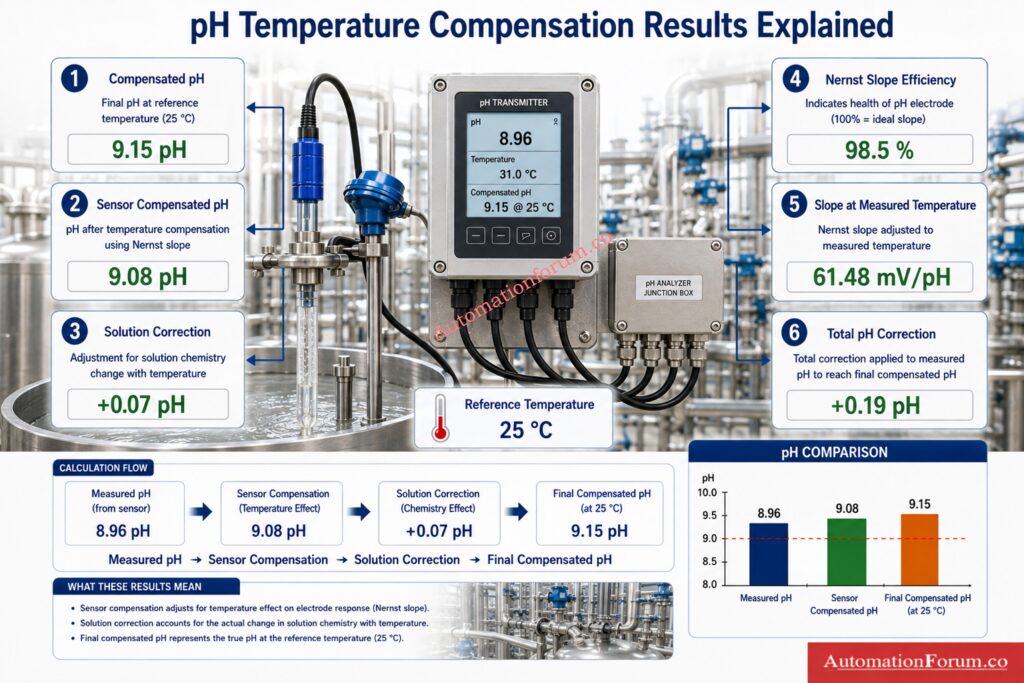

How to Interpret pH Temperature Compensation Calculator Results
The calculator provides several useful result fields.
Compensated pH at Reference Temperature
This is the final calculated pH after applying both sensor compensation and solution temperature correction.
This value represents the result after correcting the electrode response using the Nernst slope and isopotential point.
This shows the separate pH correction calculated from the solution temperature coefficient.
Nernst Slope Efficiency
Slope efficiency compares the selected base slope with the theoretical 59.16 mV per pH value.
Solution Temperature Correction
This shows the calculated Nernst slope at the actual measurement temperature.
Total pH Correction
This represents the difference between the final compensated pH and the originally measured pH.
The calculator classifies the result as Minimal Temperature Effect, Moderate Compensation or Significant Compensation depending on the magnitude of the total correction. These labels are useful for interpretation, but they should not be treated as process safety limits or calibration acceptance criteria.
