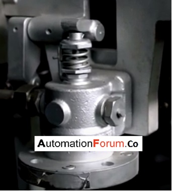

What is a poppet valve and what does it do ?
The poppet valve is used to control the flow, it could use a disc, ball, or cone to control the flow. Poppet valves are directional control valves and these valves would act very quickly. These valves are composed of movable poppet which would close against a valve seat. The ball, cone or disc in the poppet valve is used to close the seating area. In a certain type of poppet valve, the actuation force is depended on the pressure and area so in order to avoid this pressure compensation is done. Most of the poppet valves have this problem and poppet valves cannot be constructed for pressure compensation, because of this the actuation of the poppet valve is done by high switching force. So the actuation is done with the help of pilot control or lever transmission.

What is the difference between the Poppet valve and spool valve ?
Poppet valves are able to cover the internal passage by using a ball or disc and it is held by using air pressure and a spring. So when the poppet valves are actuated the poppet will be pushed away by the stem from the seat so that the flow could occur. While in case of a spool valve a spool is used to block the flow so when the spool valve is actuated then the spool will move and that could cause the seal to be close to the bore and the ports will be opened for the airflow
How does a poppet valve work ?
The poppet valve has a poppet that is movable and it would close against a valve seat the valve would be tightly closed by the pressure from the inlet. When we apply a small force to the poppet stem then the poppet would open. The stem of the poppet valve has an O-ring seal so that it can reduce the leakage. In most of the poppet valves, the poppet is held down with the help of a spring. According to the purpose of the valve, the number of poppets will vary.
