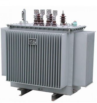

Transformers can vary, from a miniature high-frequency audio transformer to a large power transformer, the operating parameters are still the same. These can be divided into eight groups and are posted on the nameplate of any transformer of significant size: VA rating, cooling, transformer rating, frequency, voltage, phase, connections, and taps.

Cooling requirements for the VA rating(s) are usually listed on the nameplate along with the ambient operating temperature. Oil filled transformers, will include the type of cooling at which the full rated load can be delivered. A typical 1000kVA oil filled transformer that has radiators to allow natural air cooling of the oil, would be listed as:
Transformer Rating: 1000 KVA 550°C ONAN, which stands for the capability to supply 1000KVA with a temperature rise of 550°C with normal oil circulation (no fans or pumps).
The various abbreviations that you will find for transformer cooling are:
• ONAN cooling. ONAN is an abbreviation for Oil Natural (thermo-syphon) circulation with Air Naturally circulated for cooling.
• ONAF abbreviation denotes that the transformer has provision for Oil Natural Air Forced cooling. Forced air-cooling would allow the rating to be increased by a small amount.
• OFAF stands for forced (pumped) oil circulation and forced (fan) air-cooled radiators.
• OFW – The main transformers at large generating stations are OFW types with oil forced cooling, where the oil is, in turn, cooled by water
