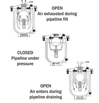

Air release valve
These valves would remove small air pockets that are accumulated in the pipeline. Mostly the orifice size of the air release valve could be between 1/16 and 3/8 it would be depended upon the valve design and working pressure. So when the air bubbles enter the valve then the liquid will be displaced within the valve because of the air bubbles and it will lower its level in relation to the float. If the level of the liquid is lowered in a place where the float is no longer buoyant, then the float will drop. Due to this process, the valve seat would open and releases the air that is in the upper part of the valve. So when the air is released the liquid level in the valve rises lifts the float and closes the valve seat.
Air vacuum valve
These valves are float operated and its orifice is big which is in the same size as the valve inlet. This valve can remove a large amount of air. The major function of this valve is to remove a large amount of air from the system when it is being filled and also it must allow a large amount of air into the pipeline when the pipeline is emptied. So when the system is filled the fluid lifts the float until it closes the orifice. So the orifice will remain closed until the system is emptied. During the operation of the system, the air could enter the valve and displace it. The valve will be closed because of internal pressure. The valve won’t open again until the system pressure reduces and reaches atmospheric pressure.
Combination air valve
This valve can act as an air release and air vacuum valve. It can do both these valves function and hence the name combination valves. The combination air valve combines air and vacuum, large orifice, and an automatic small orifice in a single body. These valves can be used with liquids that carry solid particles such as sewage and effluent. These valves can remove large amounts of air when it is being filled and also allow air into the system when it is drained. These valves can also remove air that is collected at the high point of the system. When the system is filled completely. So basically this valve has all the features of the above two valves and is also known as double orifice valves.
