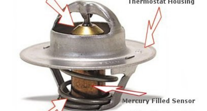

The thermostat is a type of valve that opens and closes automatically according to the coolant temperature. The thermostat is installed between the radiator and the engine cooling circuit.
Wax pellets thermostat:
This kind of thermostat is used in an internal combustion engine to maintain the core temperature of the engine at optimal operating temperatures by regulating the coolant flow to an external heat sink, usually an air-cooled radiator.
This type of thermostat operates mechanically. It makes use of wax pellets in closed spaces. The wax is solid at low temperatures but as the machine heats up the wax melts and expands. The enclosed space has an expansion provision that operates the stick that opens the valve when the operating temperature is exceeded.
The operating temperature is fixed but is determined by the particular composition of the wax, so this type of thermostat is available to maintain different temperatures, usually in the range of 70 to 90 ° C (160 200 ° F). Modern machines run the heat, that is, more than 80 ° C (180 ° F), to run more efficiently and reduce pollutant emissions.
