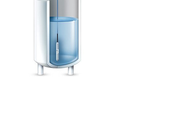

The measuring cell or the sensor of a submersible pressure transmitter is used for measuring the hydrostatic pressure at the measuring point. There is a diaphragm in the transmitter that works as a pressure sensor . Even under the most severe conditions, in the measurement of media which is dirty, containing particulates or fibres, with abrasive contents or sludge, the measuring cell of a level probe must ensure accurate and reliable measurement.We will put this transmitter in to the bottom of a tank and we have a cable that goes up to the surface .The submersible pressure transmitter will sends 4-20 mA signal corresponding to the pressure.To get the information about the pressure we need to know the depth of the tank and the length of the cable
