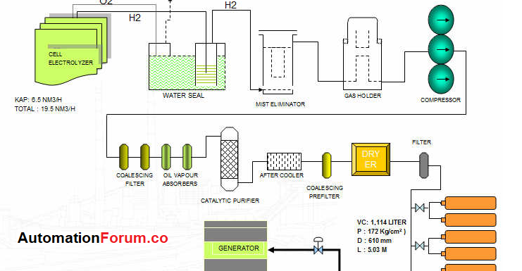

There are differences in the hydrogen plant system at the PLTU and PLTGU. The PLTGU has a plant system that is more complicated than the hydrogen plant at the PLTU. The hydrogen plant in the power plant is equipped with a compressor system, gas holder, and others. The pressure of hydrogen gas in PLTGU is far greater than the pressure of hydrogen gas in the PLTU. The pressure of hydrogen gas in the PLTGU is 26 kg / cm2.
The process of the hydrogen plant begins with electrolysis of pure water on the electrolyzer. The electrolysis process in pure water has very low efficiency, this is because water has a low ionization constant. To increase the efficiency of electrolysis, KOH is added in water. KOH is used as a catalyst that speeds up the electrolysis process. The results of the electrolysis process will produce hydrogen gas (H2) and oxygen gas (O2). Hydrogen gas produced from electrolysis will be separated from the water point by the mist separator. Once separated from the water point, hydrogen gas will be stored in the gas holder.
