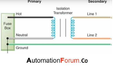

What is an Isolation transformer
An isolation transformer is a kind of current transformer which is used to supply power to equipment. It is not used to increase or decrease the voltage, they are used for other purposes like breaking a circuit into a primary and a secondary, so direct current noise can’t get through, it can prevent capacitance build-up by high-frequency noise, it also prevents unconditional ground connection between the primary and secondary and thus prevents high voltage discharge. It can provide galvanic isolation to the electrical system. Any transformer which is used to transfer signals or power is isolating because the primary or secondary is not connected by conductors instead of that it is done by induction. The transformers which have its main function to isolate circuits can be called as isolation transformers. In isolation transformer, the primary voltage value will be equal to the secondary voltage and the two windings will have the same number of turns to compensate for losses.

How to do double isolation
Double isolation can be done by putting a metallic safety shield between the primary and the secondary windings and then connecting it to the ground. So the electricity will flow to the ground in case of isolation damage and thus provides safety. Another method of double isolation is by using reinforced insulation and this type of insulation is made up of multiple layers, so if one layer breaks the next layer will provide required safety.
