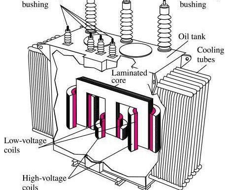

Insulation resistance testing is simply one of the most important tests that should be performed on a transformer. The winding insulation integrity is tested using insulation resistance (IR) test, but at extremely high voltages.
What is Insulation Resistance (IR) value for Transformer?
At room temperature (20 °C), it is generally advised that the insulation resistance be a minimum of 1 M? for every kV of winding rating. However, when the operating temperature rises, the recommended resistance rises significantly. For each additional 10 °C, it more than doubles.
IR Value of Transformers
Transformers are one of the costliest equipment used in distribution and transmission process of power. The transformer has to go through different testing procedures periodically to prove that the transformer works properly.
Deterioration of the transformer insulation resistance is one of the most common causes of failure of the transformer: a failed transformer is a costly replacement in an electrical system with the potential for lengthy downtime.
The transformer resistance testing will reveal a lot of details about the transformer by measuring the winding resistance of a transformer from one HV transformer bushing to another. The megger test or insulation test is carried out to ensure the healthiness of the overall insulation system of an electrical power transformer.
To find the insulation resistance between individual windings or from one winding to the ground, insulation resistance tests are conducted. Insulation resistance tests can be computed using measurements of
