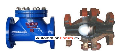

A check valve is an automatic shut off valve. Under pressure and flow, the closure mechanism opens that would allow the media to flow freely. These valves can prevent backflow in a piping system, they are also known as non-return valves. Check valves are installed to protect the piping system and equipment, if the check valves are not installed properly then it could end up in costly repairs and shutdown. Check valves would only allow the flow of fluid in one direction. There are many designs of the check valve. Some rely on the weight of the closing element and fluid flow only to close them. Others have a spring to help close them. Pressure surges could be caused by sudden closure and it would damage the pumping system and piping, so the check valves must protect them from these surges. Check valve slam could happen because of the sudden stoppage of reverse flow through a closing check valve. In order to prevent the slam, the check valve must close very quickly or a pump control valve must close very slowly, anything in the middle would cause havoc in the pumping system.

What are the types of check valves
Swing check valve
A swing check valve is a valve that uses a disc to block the flow, it is the movable part that swings on a hinge or trunnion, either onto the seat to block reverse flow or off the seat to allow forward flow. Mostly large check valves are swing check valves. The swing check valve has a flap or disk that hangs down in the flow path. When the flow is in the forward direction the pressure of the fluid forces the disc to hinge upwards and thus allows flow through the valve. During the reverse flow, the disc would shut against the seat and stops the flow.
