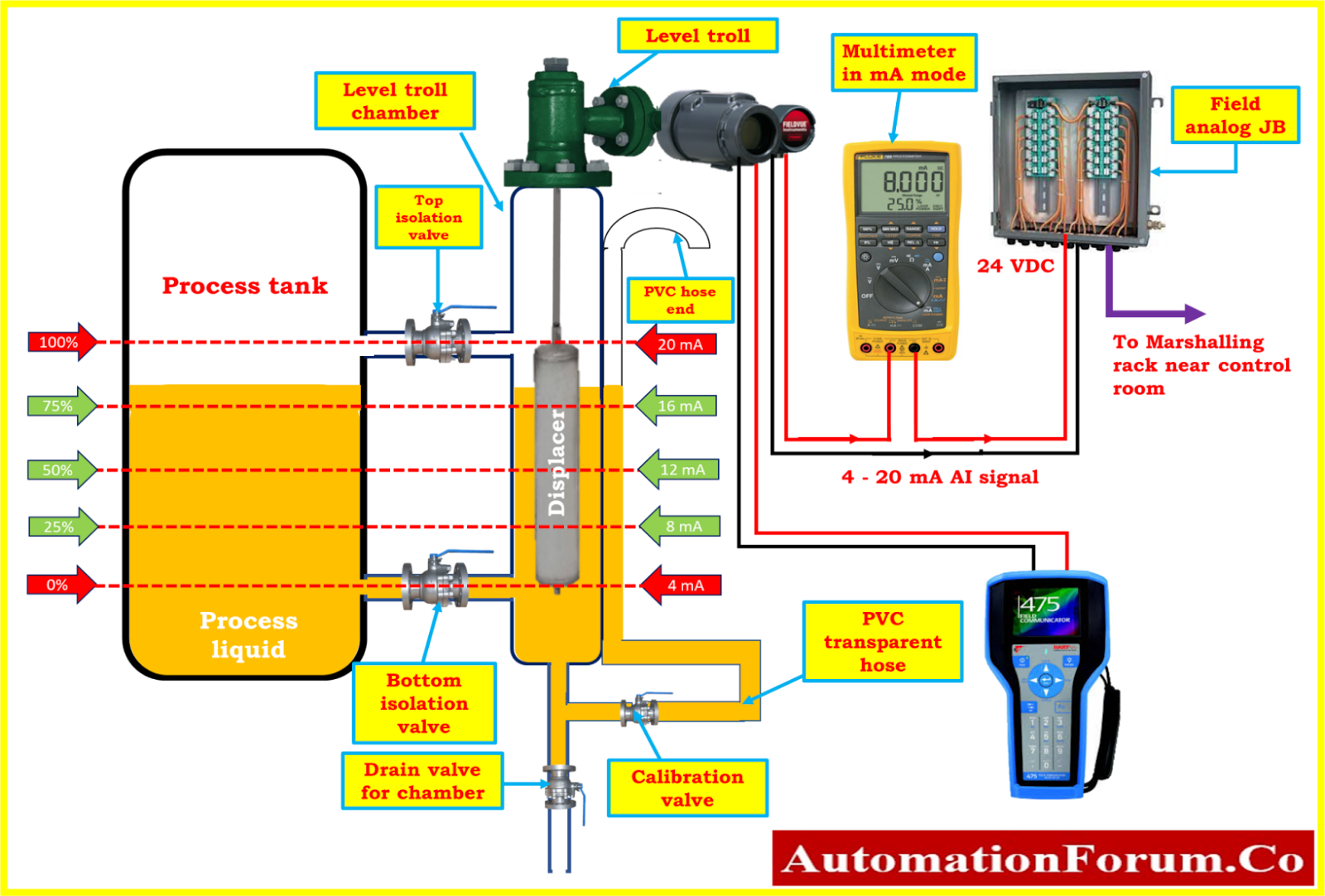

Calibration Setup
- The process area where the calibration equipment is located must be free of electromagnetic interference and vibrations. Also, the area needs to be well-lit and ventilated.
- Get together all of the necessary tools and equipment.
- In the event that the procedure poses a risk, you need to make sure that the appropriate flushing is performed so that the risk is eliminated entirely.
- Disconnect the isolation drain valve out of the system, and then open the vent line.
- Attach the ball valve with tee connection to both the drain isolation valve and the chamber in accordance with the calibration connection setup schematic that was presented.
- Attach the calibration ball valve with tee connection to both the drain isolation valve and the chamber in accordance with the calibration connection setup schematic that was presented.
- Get the transparent PVC hose whose length should be equivalent to the height of the level troll chamber.
- One end of the hose should be connected to the calibration ball valve, the other should be tied to the level troll chamber, and the hose should also be tied in between the two locations with chamber.
- The PVC transparent hose will be used as the reference level indicator for the calibration process.
- Attach the multimeter (mA mode) in series with an analogue input loop using probes and a lead between the junction box and the level troll.
- If it is a smart transmitter, you should further connect the HART field communicator with the level troll terminal.
- Presently, the connections have been made and are getting prepared for the calibration as shown in the diagram.

- Verify the stability of the level troll connections.
- Check if the power supply is 24 VDC and available in the level troll terminal.
- Referring to the data sheet will help you verify a few of the parameters. The tag number, PV, LRV, and URV are examples of typical parameters.
- If it is a smart transmitter, you will be able to check the parameters using a HART communicator.
- The calibration points for the reference level from the data sheet should be marked on the chamber by standard measuring tape.
- Certain level trolls typically arrived with an external mark on the chamber’s outside in percentage.
- Now, turn off the drain valve, and manually fill the chamber with the process fluid—for example, water—through the PVC hose or from the top of level troll chamber until it reaches the 0% percentage mark on the chamber.
- Using the clear reference hose and the reference marker on the level troll, gradually bring the fluid level into alignment and make it as parallel as possible.
- Now, refer to the multimeter, which should be displaying 4mA.
- If the 4mA reading is not being displayed, locate the zero adjustment on the level troll and make the necessary adjustments until the reading reads 4mA; or, use the HART Communicator to make the necessary adjustments for smart transmitter.
- Referring to the level troll manufacturer’s maintenance instruction booklet is required at all times in order to locate the zero and span adjustment in level troll.
- Fill the chamber with water using the PVC hose until the 100 percent mark on the chamber is reached.
- Bring the fluid level gradually into alignment and as close to parallel as possible.
- Refer now to the multimeter, which should be displaying 20 milliamperes (mA).
- If the 20 mA reading is not displayed, locate the level troll’s span adjustment and make the appropriate adjustments until the reading displays 20 mA; or use the HART Communicator to make the necessary adjustments for a smart transmitter.
- Do the procedure for calibrating the level troll as many times as necessary until it is calibrated to the required tolerance.

- Do linearity checks at 0%, 25%, 50%, 75%, and 100% fluid level output in the upscale and downscale directions to make that the level troll is producing the correct output values.
- If the output value does not fall within an acceptable range, calibration is required. Once more, if the output values have deviated from the permitted range, the level troll needs to be repaired or replaced.
- If all output values (+/- %) fall within acceptable bounds, no further calibration is required.
- The output data should be entered in the as found/as left column of the blank calibration report.
