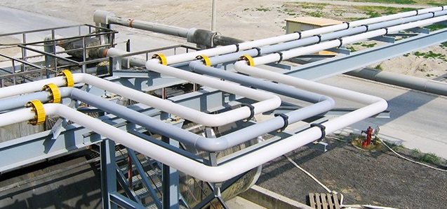

36.What are design considerations for pipe rack ?
Ans: Rack width, no of levels and elevations, bent spacing, pipeflexibility, Access and maintenance of each item in pipe rack.
37.What are steps in rack design?
Ans: Generate line routine diagram, Calculate bent spacing, set width of rack, decide elevations and levels.
38.What is pipe bent?
Ans: Pipe bent consists of a vertical column or columns and a horizontal structural member or members that carry piping systems, usually above the headroom.
39.What factors affect pipe span?
Ans: Size, Schedule, liquid or vapor, insulated or bare pipe.
40.What are spandrels?
Ans: Horizontal structural members located along the longitudinalcenterline that are used for structural stability, pipe support orintermediate pipe bents.
41.Which lines placed where in rack ?
Ans: Process lines on lower level, utility lines on top level, instrument and cable trays on utility level or separate topmost level, Heavy lines near columns, Flare line outside rack on cantilever beams or inside rack above top level , steam lines with expansion loops on one side of rack, line switch orifice runs on one side of rack beside columns for maintenance using portable ladder.
42.How much extra space required for rack ?
Ans: 20 % extra for future lines.
43.How to route steam lines on rack ?
Ans: Steam headers on top level or rack, determine growth by multiplying coefficient (From nomograph) of expansion by length of line.Try anchor in middle, determine growth of each branch and see weather the have enough flexibility, if not anchor at ¼ th distance on both sides,determine amount of expansion leg from nomograph, and decide loopsize. Line that require largest expansion leg should be located on the outside of the loop.
