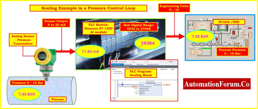

Scaling Example in a Pressure Control Loop
Referring to above displayed image, let us think about a practical situation in which a pressure transmitter tracks steam header pressure and sends this value to a PLC for control and monitoring.
System Overview:
- Sensor Type: Pressure transmitter
- Range: 0 to 16 bar
- Signal Output: 4 to 20 mA
- PLC Module: Siemens S7-1200 AI module
- Raw Digital Range: 5530 to 27648 (for 4–20 mA input)
Objective:
Convert the raw PLC value into a pressure value in bar.
Let’s assume the current raw input from the analog module is 16384.
Step-by-step Scaling Calculation:
Known Parameters:
- R=16384
- Rmin=5530
- Rmax=27648
- Emin=0
- Emax=16
Apply the Formula:
Result:
The process pressure is approximately 7.85 bar.
