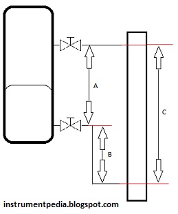

Example calculation:
Low S.G=0.802
High S.G= 0.992
A= 810mm (measurement length)
B= 410mm (off set)
C=A+B=1220mm (Displacer length)
0%Â Â Â = (High S.G x off set length) + (low S.G x A)
= (0.992 x 410) + (0.802 x 810)
= 406.72 + 649.62
= 1056.34mm
100% Â Â Â = (High S.G x C)
= (0.992 x 1220)
= 1210.24mm
