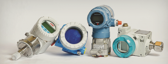

Difference between Conventional transmitters and Smart transmitter
Transmitters are essential components in the process industry. And change is inevitable in the industrial sector as of all other fields, many of the conventional instruments were replaced with smart instruments. Smart instruments are much-sophisticated equipment with digital displays and provide much more to access to control the equipment.
Still, for some applications, conventional transmitters are used especially at few hazardous locations. Here we up to discuss the main difference between the smart transmitter and Conventional transmitter.
