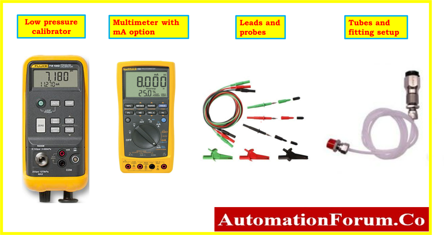

Tools required for DP transmitter calibration:
Calibration of DP level transmitter at field 1
  • Necessary hand tools.
  • Standard low Pressure Calibrator.
  • Standard Multimeter.
  • Test leads and probes.
  • Tubes and standard fittings
  • Soft Cloth for cleaning.

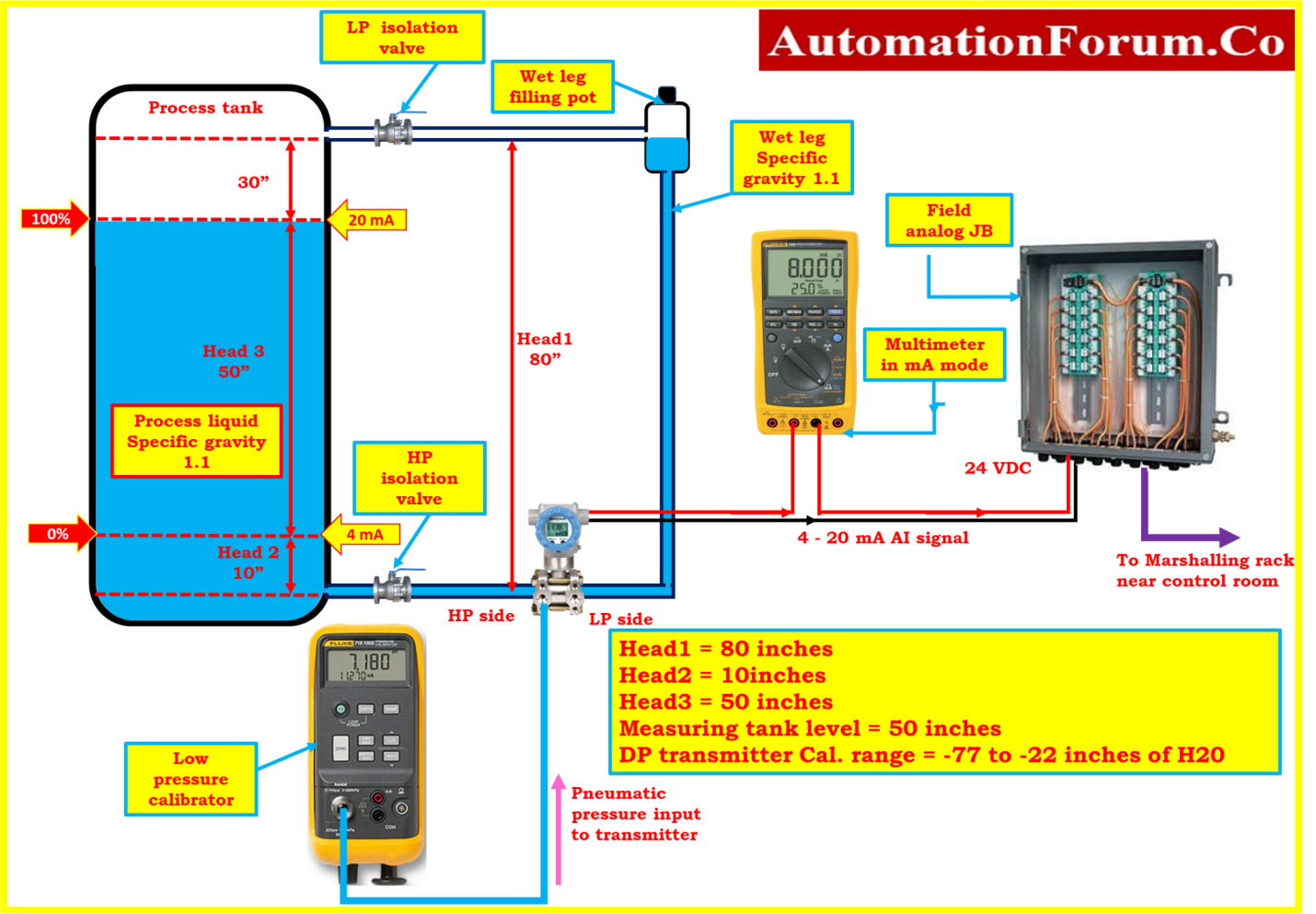

Calibration Setup for DP type level transmitter
Calibration of DP level transmitter at field 2
  • Electromagnetic interference and vibrations must not exist in the process region where the calibration equipment is placed. Also, the area needs to be well-ventilated and illuminated.
  • Get all of the essential instruments and tools in one place.
  • In the event that the operation involves a danger, you must ensure that the necessary flushing is carried out in order to completely eliminate the risk.
  • Open the equalizing valve and close the transmitter manifold‘s LP and LP isolation valves.
  • Drain the process fluid from both the HP and LP side legs by opening the drain valve in the impulse line on both sides.
  • Clean the fittings and any remaining fluid in the transmitters after disconnecting the HP and LP side impulse lines from the transmitter manifold.
  • Check the transmitter HP & LP pressure ports to make sure they are dry.
  • The output of the low pressure calibrator should be linked to one end of the tube, and the high pressure side (HP) of the DP transmitter should be connected to the other end. Make sure the connections are tight and leak-free by inspecting them.
  • The transmitter’s low-pressure side (LP) is always kept open to the surrounding atmosphere.
  • Between the junction box and the DP type level transmitter, use probes and a lead to connect the multimeter (mA mode) in series with an analogue input loop.
  • The HART field communicator should also be connected to the DP type level transmitter terminal if the transmitter is smart type.
  • The connections have been established and are currently being prepared for the calibration of the DP type level transmitter, as shown in the diagram.

  • The LRV and URV can be estimated using the tank dimensions, fluid specific gravity, and transmitter HP and LP tapping positions.
  • For example, if the transmitter is installed as indicated in the calibration setup picture above, the transmitter’s LRV and URV are determined as detailed below.
Example calibration
Head1 = 80 inches = Height of the LP side of the transmitter.(wet leg Filled with process fluid)
Head2 = 10 inches = 0% of Measuring range.
Head3 = 50 inches = Actual measuring range of the level.
Measuring tank level = 50 inches.
Specific gravity of the fluid = 1.1
DP transmitter Cal. range = -77 to -22 inches of H20
At zero percentage of level (for 4mA output)
DP   = Phigh – Plow
  = Head2 – Head1
  = (1.1 X 10”) – (1.1 X 80”)
  =11” – 88”
 At 4 mA = -77”H2O
At 100 percentage of level (for 20mA output)
DP   = Phigh – Plow
  = (Head2 + Head3) – Head1
  = [(1.1 X 10”) + (1.1 X 50”)] – (1.1 X 80”)
  =11”+55”-88”
At 20 mA  = -22”H2O
Cal. Range = -77 to -22”H2O(4 to 20mA)
